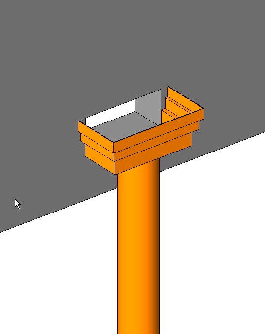

Hi all
I think I have covered all the variations of this item. My question is  - What is the best method to create the one shown in the image
Many thanks

Build it like you would a door ... wall hosted with an opening cut.

I appreciate the response WWHub but I dont think that its quite what Id hoped for. If you look at the attched pdf it shows what we call a hopper in the UK that the downpipes for rain water gather.. so I am looking for the best way to create the exterior shape.

same answer ... the shape is nothing but a 3 sided sweep... something we sometimes do with door trim but in this case, the sweep is in plan
