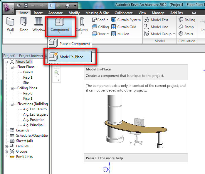

Hi,
 Im having some issue in regards to sweep editing in project environment....the sweep was created in the project but cant seem to be able to edit the path or profile...?????????
Thu, Apr 30, 2009 at 1:45:08 PM | 2010 sweep editing
Joined: Tue, May 22, 2007
5921 Posts
4 Stars: 205 Votes
And how it was "created in the project"?????
Thu, Apr 30, 2009 at 2:04:27 PM | 2010 sweep editing
LEVIT
Joined: Wed, Jul 2, 2008
6 Posts
massing and site > in place mass
Thu, Apr 30, 2009 at 2:26:16 PM | 2010 sweep editing
5921 Posts
4 Stars: 205 Votes
The OLD create in-place is in "HOME-COMPONENT-MODEL IN-PLACE", here you can draw by "Solid Extrusion, blen, sweep....., the "massing and site > in place mass" is the OLD "MASSING"....

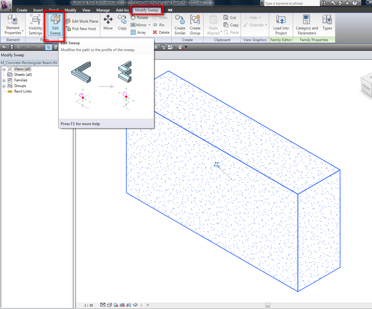

What if the sweep was created in an RFA file?
I can't find the same menu options when editing the family.
I'm attempting to modify an existing concrete t-beam.
Thu, Sep 10, 2009 at 12:51:11 PM | 2010 sweep editing
5921 Posts
4 Stars: 205 Votes
RFA file is a "Family", RVT file is a "Project", when you "Edit" the family and you pick in the object you have option to edit and change what you want....

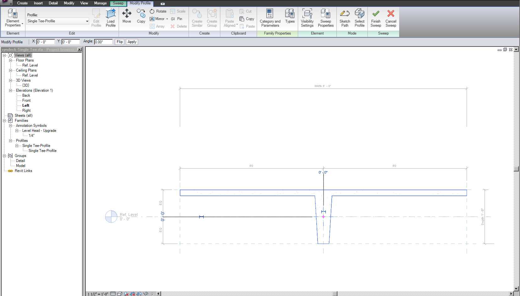

Thu, Sep 10, 2009 at 1:00:17 PM | 2010 sweep editing
#9
gouldse
Joined: Mon, Aug 10, 2009
6 Posts
I'm attempting to modify an existing concrete t-beam and I can't edit the "patern"
Edited on: Thu, Sep 10, 2009 at 1:22:32 PM

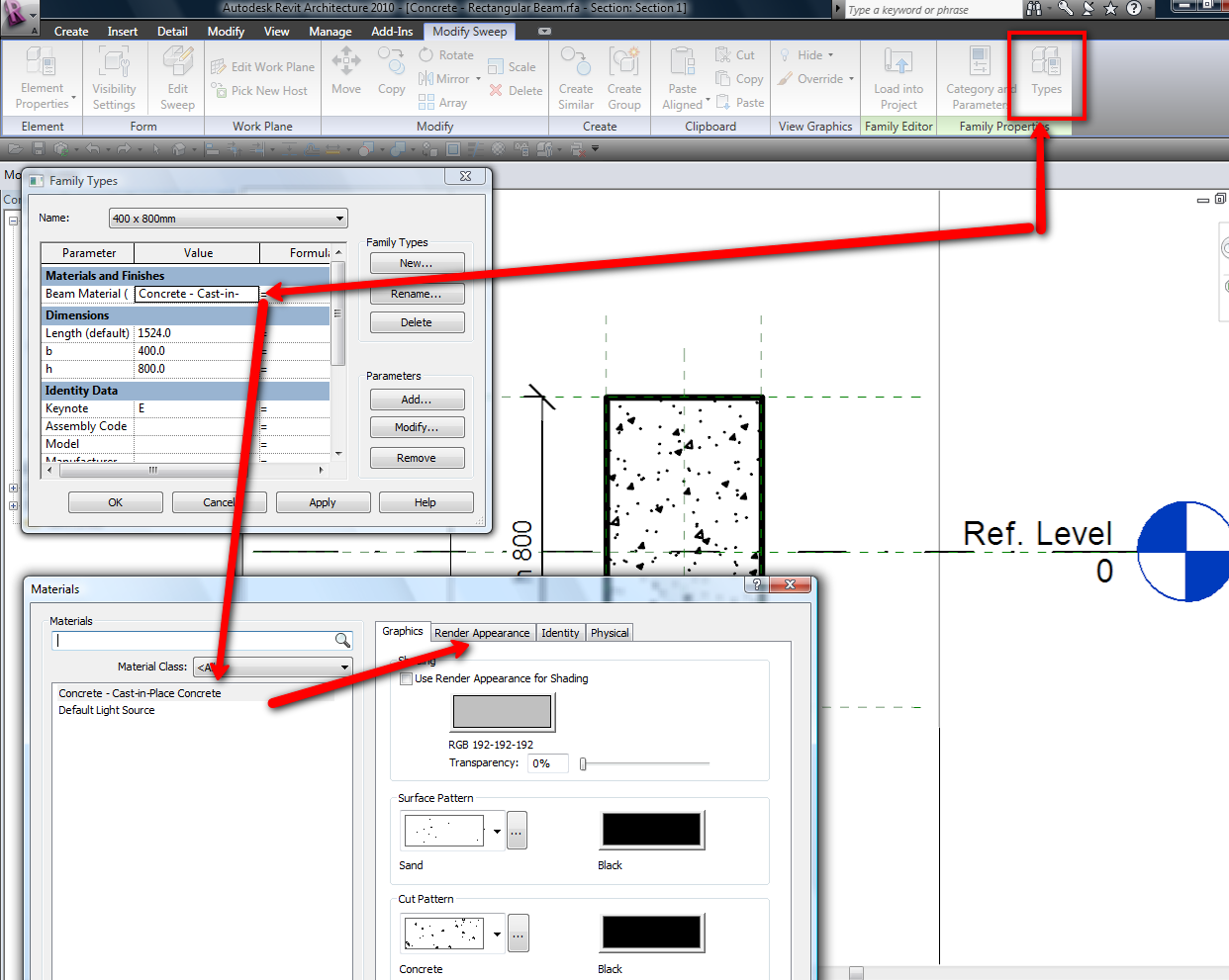

Thu, Sep 10, 2009 at 1:56:41 PM | 2010 sweep editing
#11
5921 Posts
4 Stars: 205 Votes
The "pattern"??
follow the arrows...

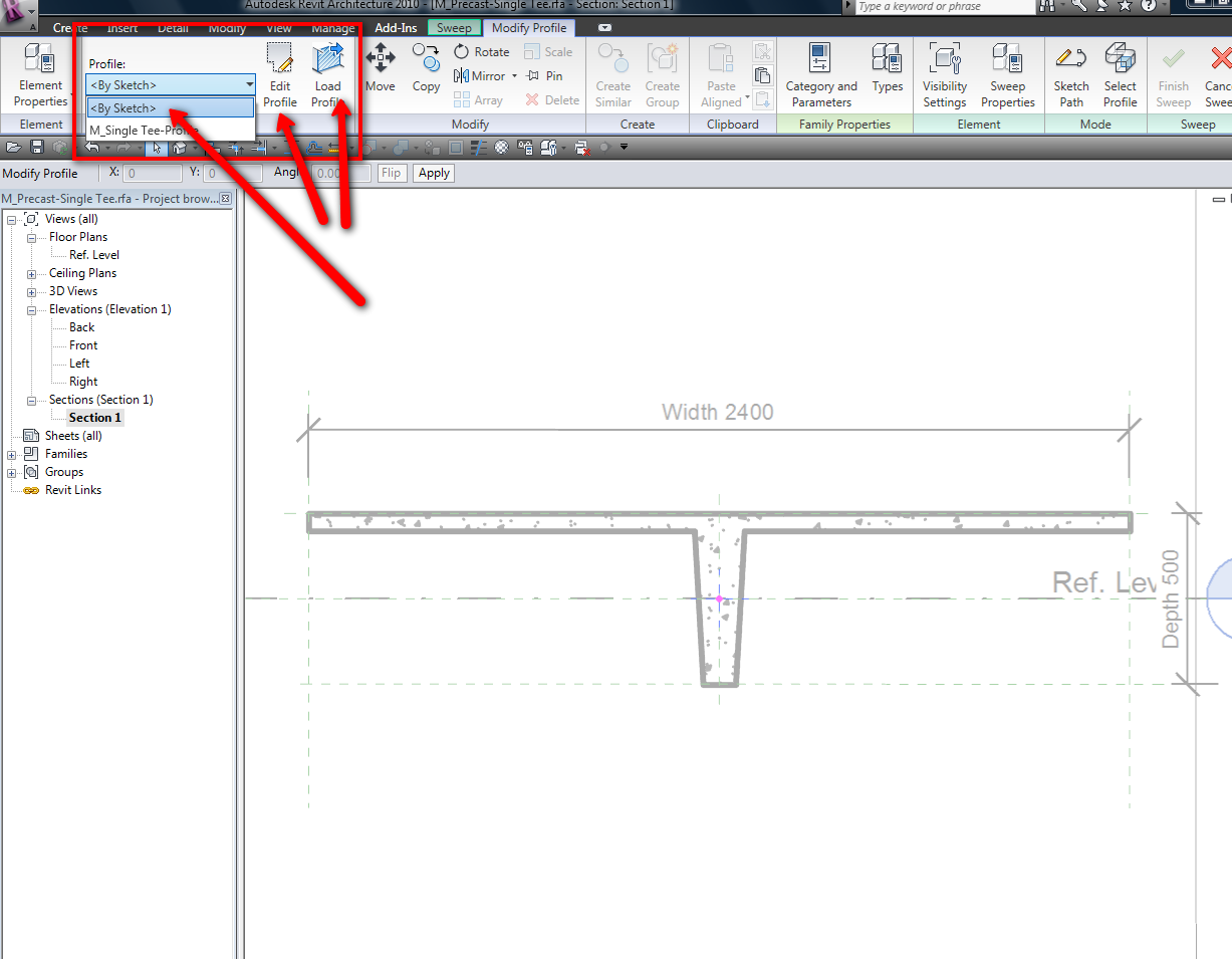

Thu, Sep 10, 2009 at 2:43:04 PM | 2010 sweep editing
#12
gouldse
6 Posts
My terminology my be off a little.
maybe this picture will help.
Thu, Sep 10, 2009 at 3:52:51 PM | 2010 sweep editing
#13
5921 Posts
4 Stars: 205 Votes
You can Load a Profile already created in a "Profile Family" (because that's the case you have in this family) OR you can change to "by Sketch" and draw the new profile you want to that Croncrete T-Beam....

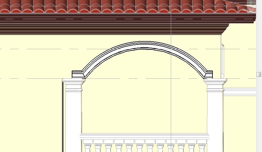

Tue, Mar 23, 2010 at 5:52:58 PM | 2010 sweep editing
#14
Joined: Thu, Nov 15, 2007
4 Posts
4 Stars: 3 Votes
I created a sweep on the arch but I need to return it to 90d at the corner and at the end too.
Please help!
Wed, Mar 24, 2010 at 4:42:34 AM | 2010 sweep editing
#15
5921 Posts
4 Stars: 205 Votes
I don't understand what you need....
