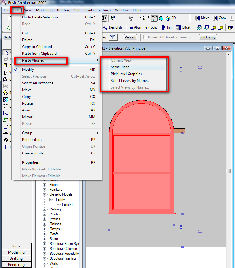

I impoted a autocad plan into revit and I proceeded to build the first level and second level on level 1 of my project in revit. Is there a way to select one of the floors and move it or stack it on top of the other floor? I tried to move it, but it will not let me move it vertical. Can someone please advise. Thanks!

Hi rmwilkening, "I impoted a autocad plan into revit and I proceeded to build the first level and second level on level 1 of my project in revit." First, try to avoid it, save each levels in different files in CAD and import them into Revit in their respective levels. Second, just copy/paste to the second level that plan.....
