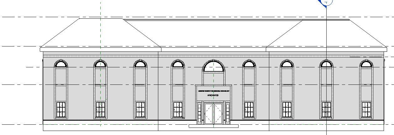

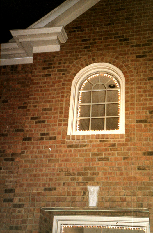

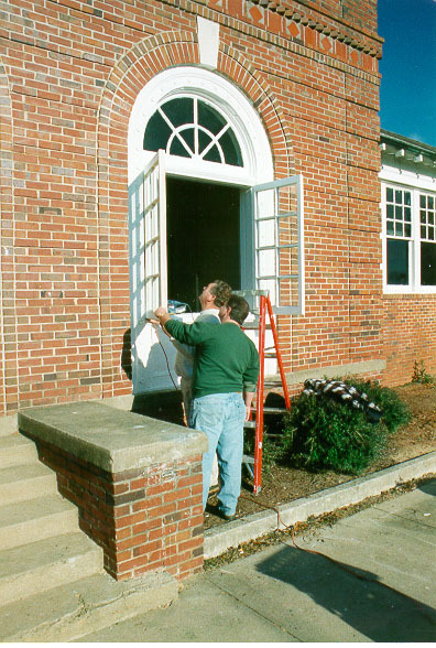

Hello - I'd like to know if it's possible to incorporate a similiar brick design as shown in the photos below into my building.  I've figured out how to do brick sweeps and reveals with the horizontal and vertical members, but is it possible to do it in an arch?  I've found links to place a decal, but that doesn't show up when I soley want a black and white elevation.

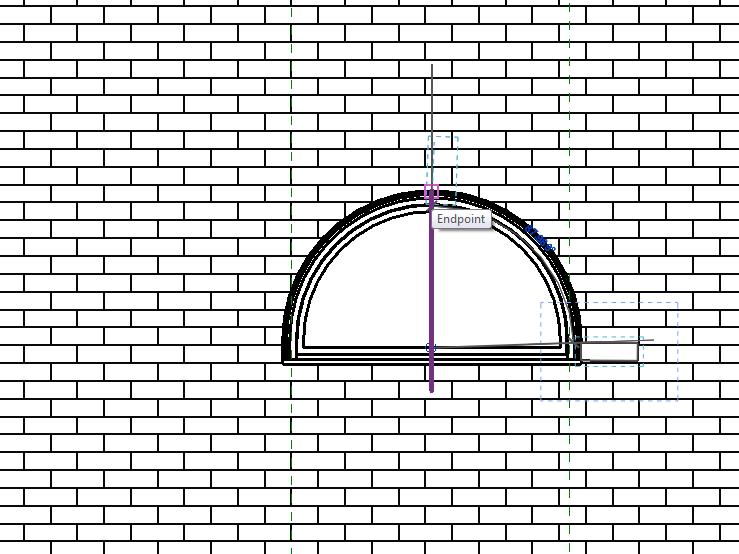

Thu, Apr 30, 2009 at 11:19:04 AM | Brick Arch Around Window
sasvqf
Joined: Sun, Mar 15, 2009
4 Posts
Thanks!  That video helped a lot - I understand how to do it.  (I've just started playing with Revit this week, so this is all new to me)

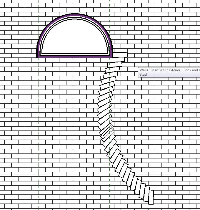

I'm having a problem with the array now.  I'm sure I'm setting it up right, but when I click, the bricks all go the wrong way and don't look anything close to what you have.  Any suggestions would be great!
Thu, Apr 30, 2009 at 1:27:19 PM | Brick Arch Around Window
Joined: Tue, May 22, 2007
5921 Posts
4 Stars: 205 Votes
You are doing something wrong....
Sat, May 2, 2009 at 5:53:37 PM | Brick Arch Around Window
sasvqf
4 Posts
I got it figured out - I needed to create the brick as a "generic model face based."  Thanks for the help!
