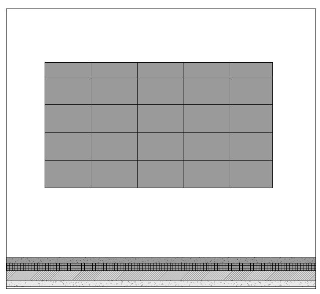

Fri, May 1, 2009 at 4:21:23 AM | Wall tile areas
tim123
Joined: Tue, Apr 12, 2005
1310 Posts
4 Stars: 19 Votes
Use the split face function.  The areas can still be scheduled.

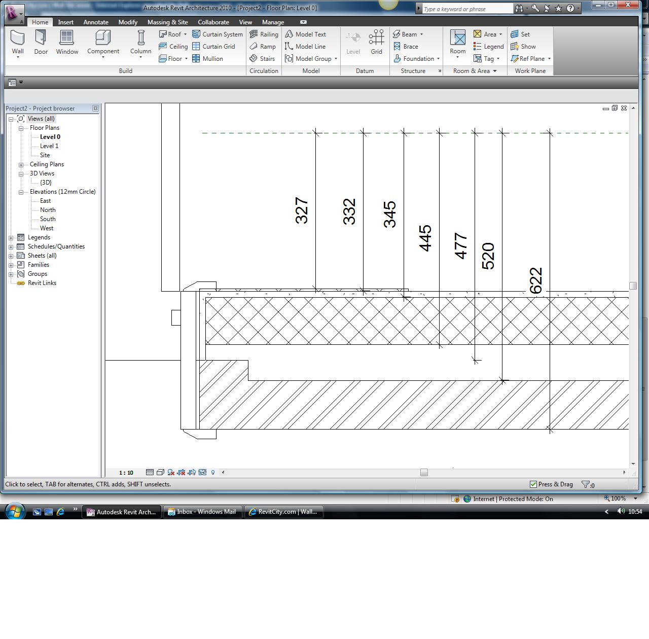

I don't think that you can include worksets in view templates.  With respect to the dimensions, you should be able to dimension to any line - see image.  You may need to temporarily hide the joined wall to snap to the surface though.

I thought I was going crazy given WWHub's comments, but glad to see that might not be true. You are right, if you temporarily hide the 1/4" wall, you can dimension to the stud wall.

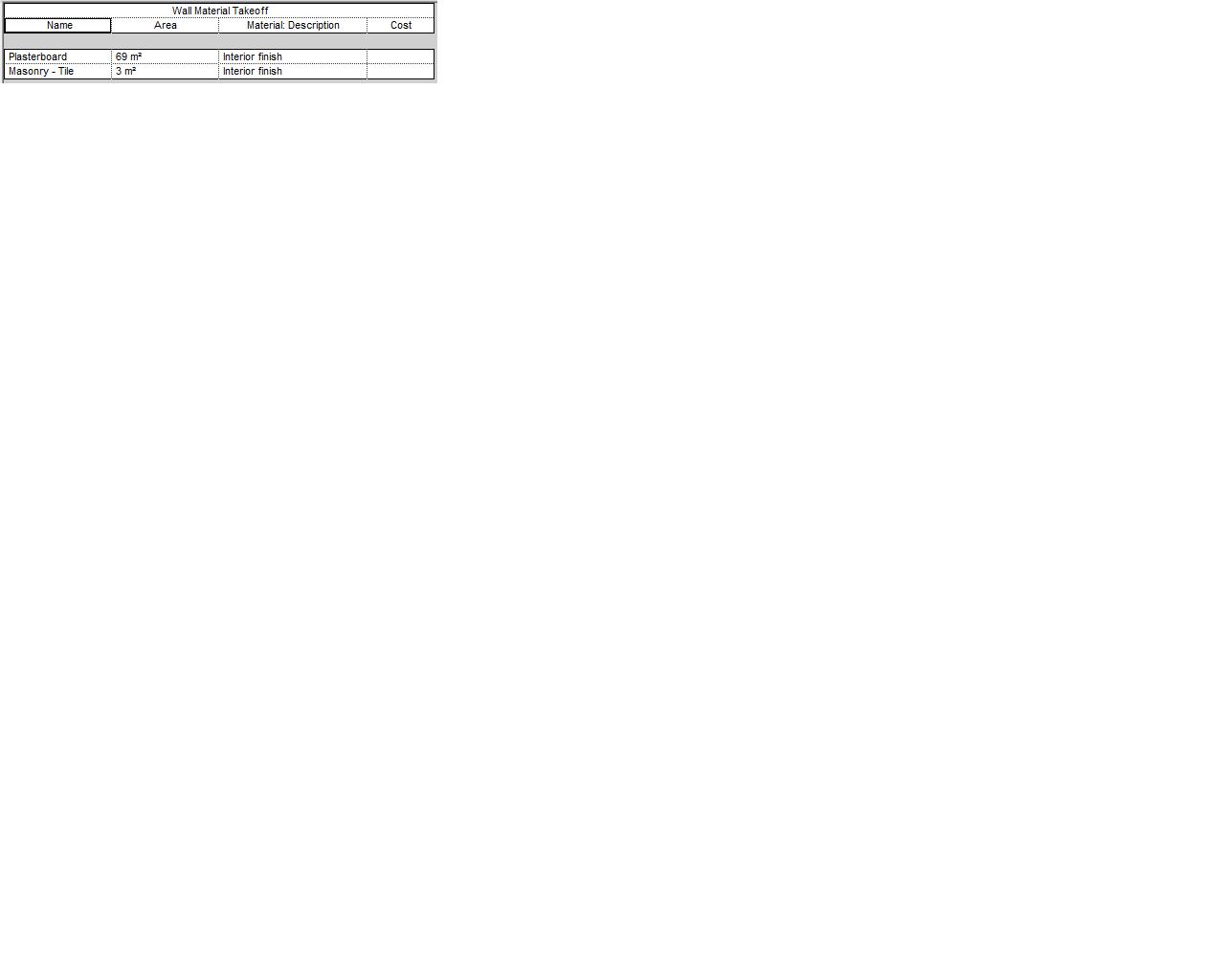

Mon, May 4, 2009 at 7:19:25 AM | Wall tile areas
#9
tim123
1310 Posts
4 Stars: 19 Votes
Create a schedule - material takeoff -wall.  Add in the fields that you require - my example shows name, area and cost.  The other field, description, is used as a filter so that the other wall components are not shown, such as insulation and blockwork.  This field can be hidden if required.  The filter is by description and only includes fields that are interior finish.
