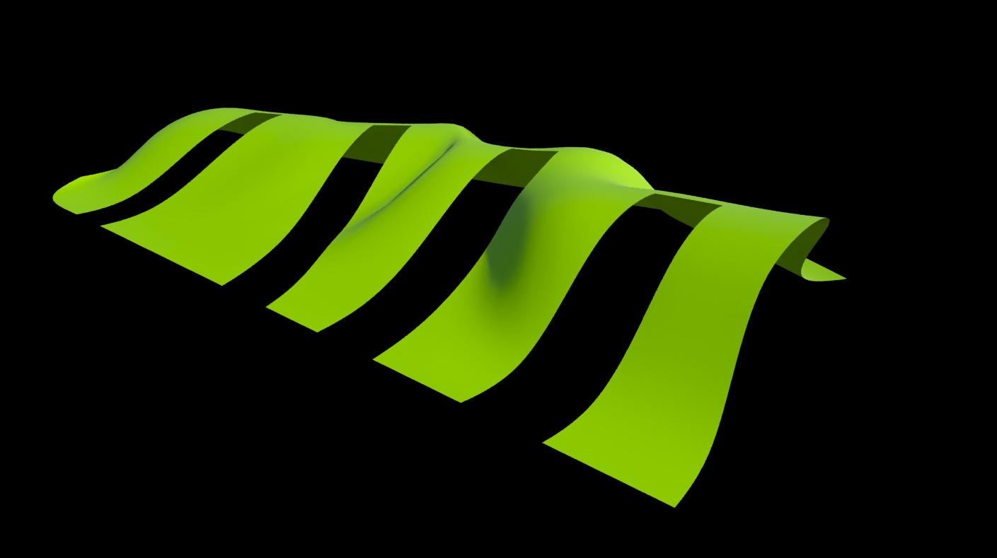

Hey everybody,
I have a question about how I can add a material to a mass imported from rhino. I have been surfing around and I can't seem to find a answer ( I am a bit of a rookie though so I might have missed something obvious :D )
I have imported the geometry via a .sat file from rhino into a revit family file. I then click on the geometry and go to
1. element properties
2. visible
3. add parameter...
This opens the parameter properties menu, from here I choose
1. family parameter
2. set group parameter to materials and finishes
3. choose a name
This is where my problem begins though. The menu "type of parameter" is greyed out and fixed on "yes/no" rather than on "materials" as I need.I imagine that it might be because I have have a problem with the imported geometry?
 Am I trying to do something that can't be done or am I missing something in my workprocess?
I am using Revit Architecture 2009 (I hope I am posting in the right forum?) and am attaching the file in question
Any help would be greatly appreciated :D

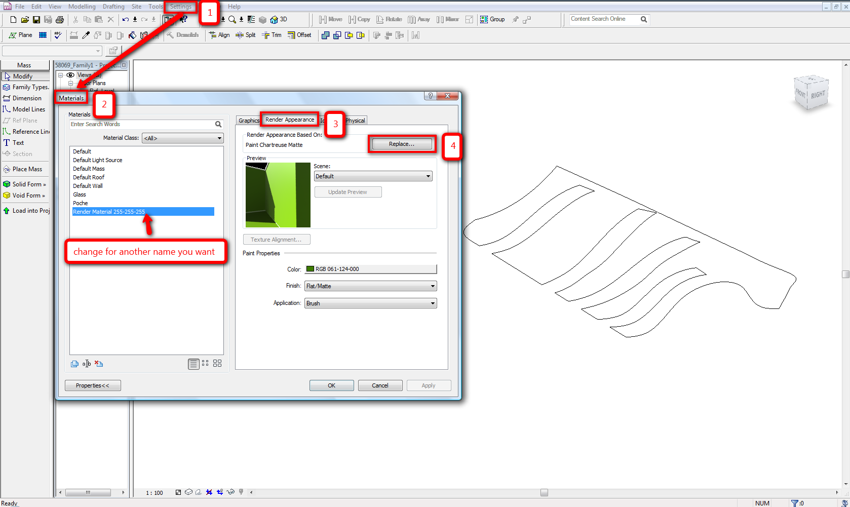

Hi jutoft, look, when you import to Revit a model made in Rhino, you always will find its materials here: Settings-->Materials... (see image). Depending on the colors you gave to its components (i.e. blue for glass, etc.), you´ll find them with names like "Render Material 255,255,255" which will be assigned with a blue color, what you have to do is to assign a material to each component (see image). This is also effective to models imported from Sketchup, 3ds Max (both via .dwg type files) and AutoCAD.

Rather than do this, I recommend going to settings-->Object Styles-->Imported and linking the layers to materials of regular naming.  This way you don't end up with materials that are specific to certain families.
Regards,
Chris.

Thank you very much, that did it!
