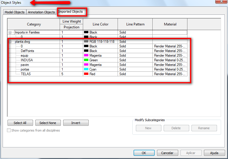

When I import autocad into revit I am stuck with line colors I don't know how to change.  Where can I change them??
 Sincerely,
 Maor
Tue, Apr 28, 2009 at 1:45:37 PM | Revit Line Colors
Joined: Tue, May 22, 2007
5921 Posts
4 Stars: 205 Votes
Did you try in "Object Styles"???

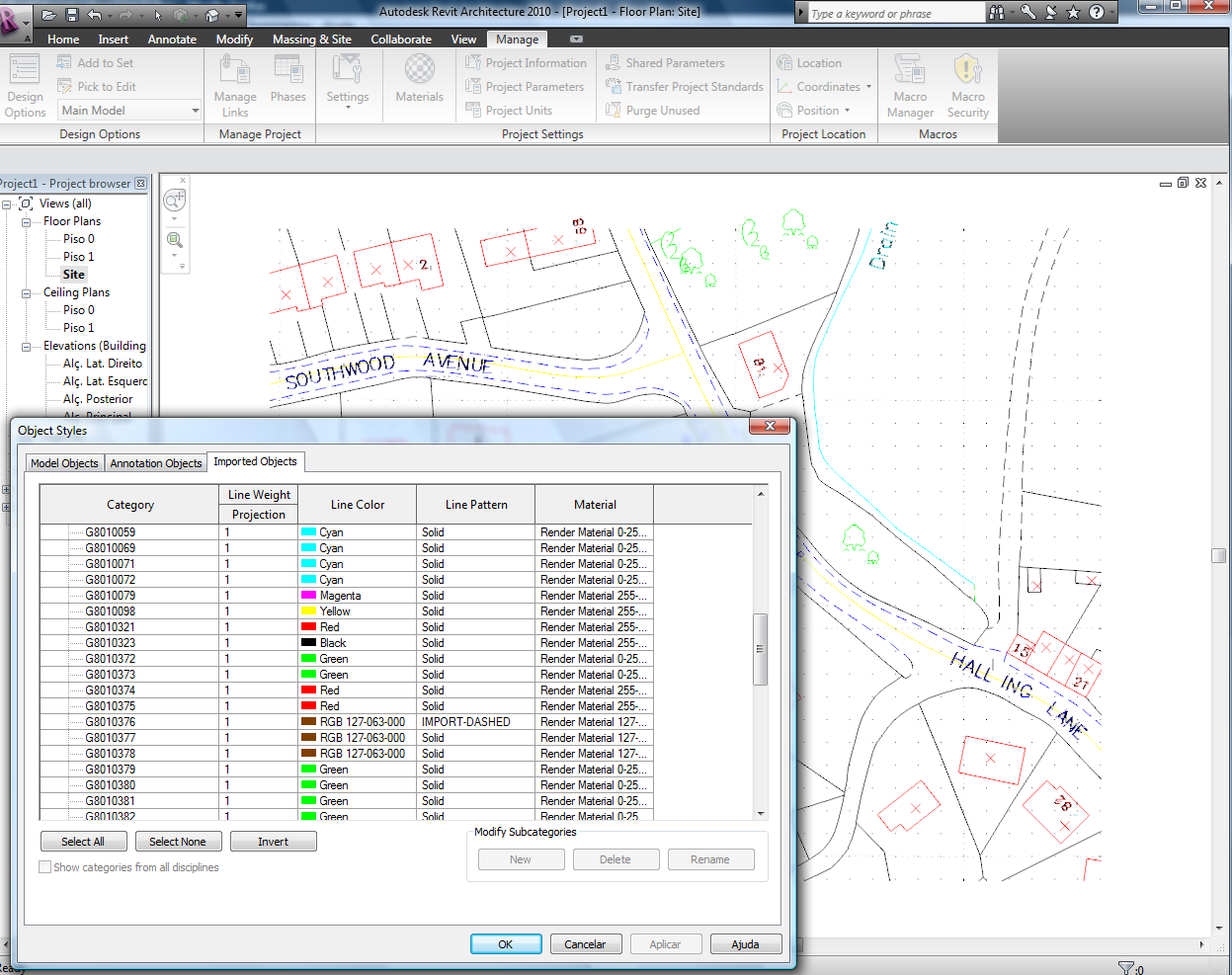

Tue, Apr 28, 2009 at 2:25:45 PM | Revit Line Colors
mark2001
Joined: Wed, Apr 22, 2009
5 Posts
yes and no luck,  they all show black??
but I still have color in the view
Tue, Apr 28, 2009 at 2:52:55 PM | Revit Line Colors
5921 Posts
4 Stars: 205 Votes
What??? in your view you have your lines (cad) with colors and in the "Object Styles" all of that Categories (layers) are in black??? is that ???? when you import that cad file you choose "Preserve Colors"???

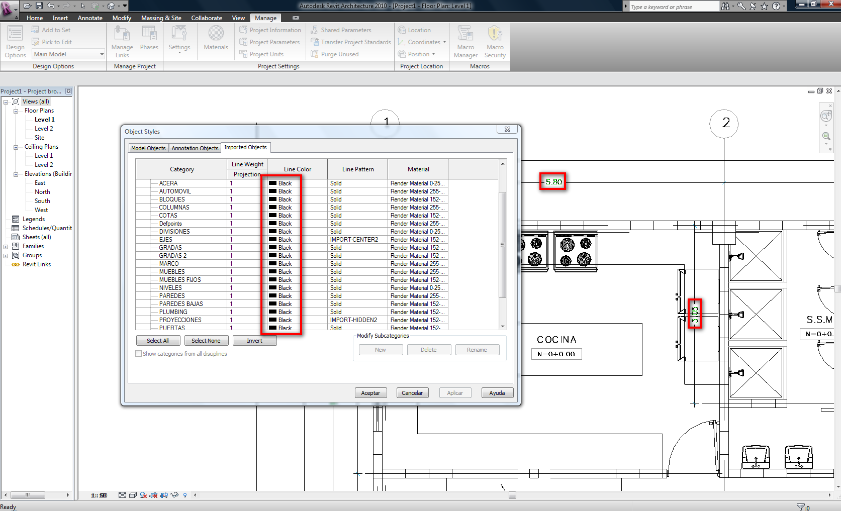

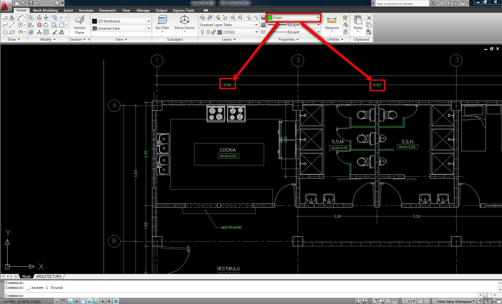

Hi mark2001, are you sure that when you draw your lines in AutoCAD you draw 'em By Layer and not By color. In the image attached you can see that all my imported drawing is in black except the numbers of the dimensions that are in green because I have them By color and not By Layer, so check this....
