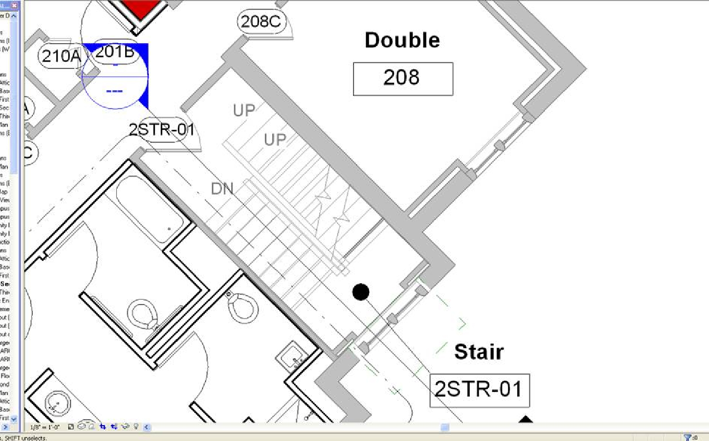

I have a 4 story building with a basement. When I am on my 2nd floor, I see not only the 2nd floor stair going up, but see the down as I should. However, the down does not stop and I continue to see it as it goes under the stair going up and even when it passes below my floor plate.
 I have tried making these stairs as a multi-story stair or separate stairs per floor. The issue is there regardless of how they are constructed.
 It is almost as though the stair going up and the floor are transparent. But, they are not. i have no underlays on, and all items are solid, no transparency.

I have tried that option as well. However, it only works on the "UP" stair. I still see the stair below including it's up arrow from the first floor.

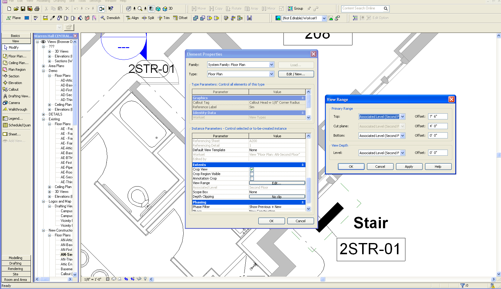

post your view properties showing your view range
Tue, Apr 28, 2009 at 2:51:47 PM | Stair Visibility Issues
stewajm
Joined: Wed, Aug 2, 2006
4 Posts
Attached is a jpg of the view properties.

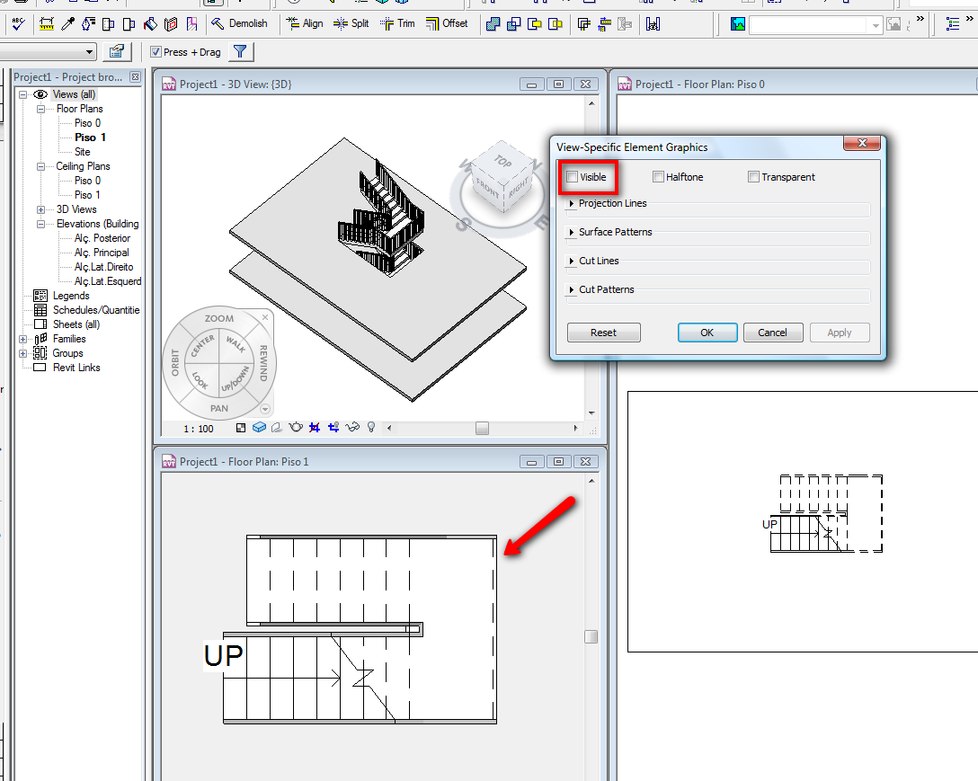

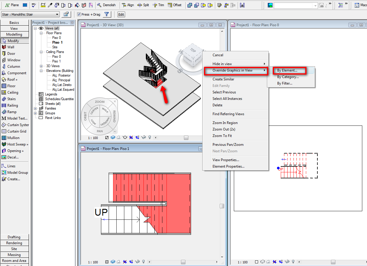

Did you try in that plan view going to the "Override Graphics in view>by Element and turn off the "Visible"??? if this is what you want....

Typhon has probably given you a work around by just turning that stair off if it is a seperate stair but it should not be showing according to your view range..... BUT - Do I by chance see a plan region around the lading window ?  Is there something with that which is affecting us?  Why not delete that and see what happens.

That works, but then I don't see the down. I'd like to be able to see both the up and down as I should be able to.
