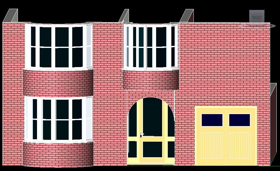

OK, My project is slowly coming together but I've run into a problem with getting some detailing around my arched opening in my building.
I want to create a brick soldier course which runs around the arch over the door but I have absolutely no clue how to do this. Please can somebody explain how I can do this.
I have attached an image for you to look at.

First I think you will need a new brick colored material that matches your brick color but doesn't have any joints.
Next, I would create a simple, single brick family that you can apply the material to and array arond your opening.  You could do this as an inplace family ... but then you wouldn't have anythging for the future.

I made this video to other guy but i think this explain the problem: http://screencast.com/t/4SEObmZCs

See another one to that guy: http://screencast.com/t/yQJZrXxJC

There is a family here: http://essentialbim.com/product/brick-arch/ that works Very well.
The Calculations allow it to flex so you can easily align it to your window/door, there are parameters for brick height, depth, number of bricks, arch radius, height from window to bottom of Arch etc. as well as material parameters to change the brick colour and the mortar.
