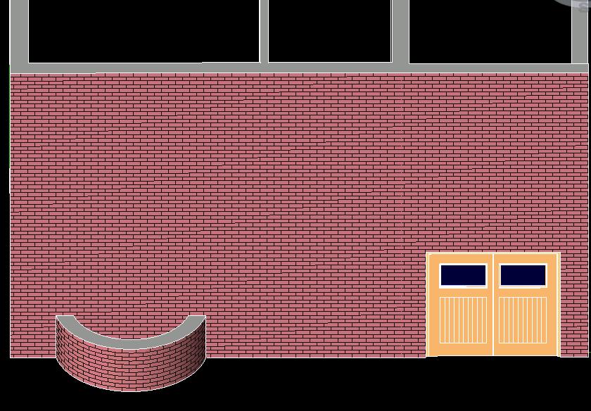

Hi guys. I'm struggling in getting windows to fit around a curved bay. When I try to insert a window it just doesn't look righ at all. I have attached an image of the bay I'm trying to get the windows around. The only way so far that I have been able to get some sort of result  is by taking the bay all the way up to the wall plates on second storey level and then inserting the windows but the problem then is that the the external brick wall that is behind the bay stops the windows from becoming transparent.
Any ideas on the best way to get these windows looking right?

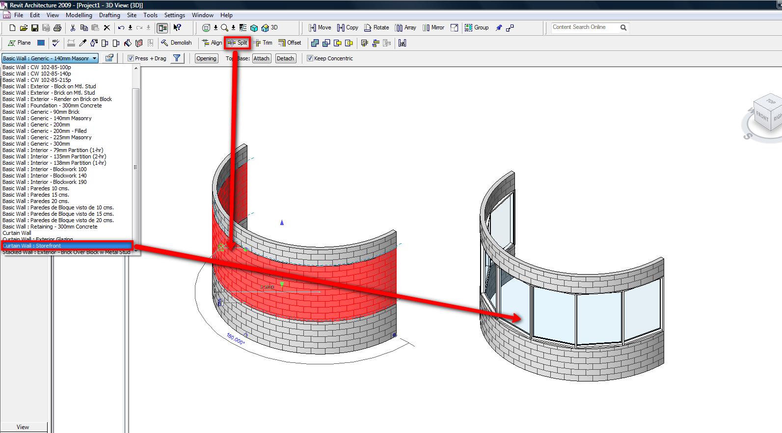

Hi ksmith, one way you can try is to connect your curved wall to the second level, then split it with the height of the window you want and then change it to a "Curtain Wall:Storefront".....
