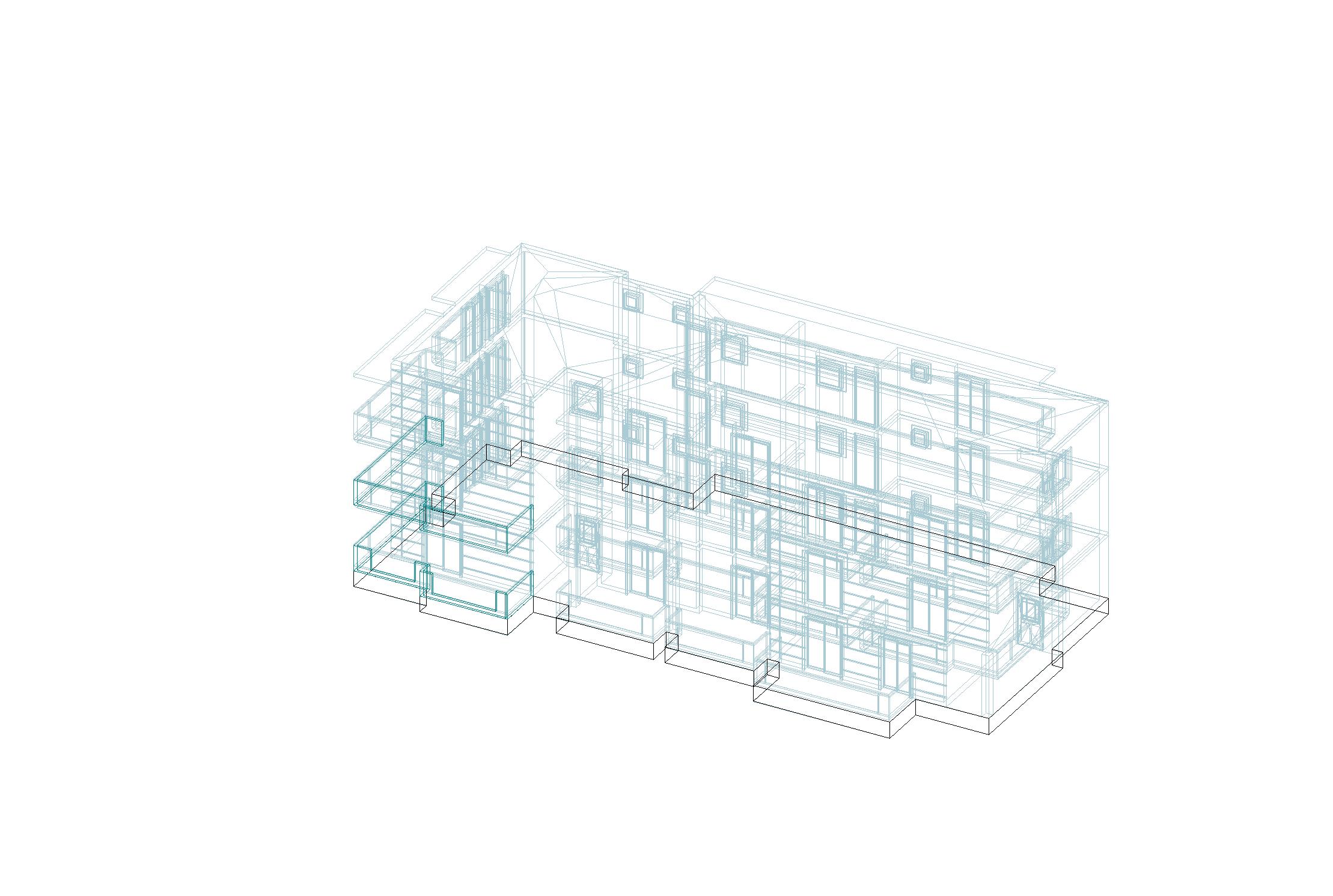

do you see how i've started to build this
model by tracing the floor?
but without being able to cut this wireframe
into sections- tracing many of the parts
becomes impossible.. THERE HAS TO BE
A WAY TO BUILD ON THIS..
also it would be nice if the elements
you built on this wireframe could be
shaded without the rest of the wires being
shaded so you could see what you have
built and what still needs to be built?

Why don't you do this project like you would from the begininng?  Create multiple levels and have your CAD dwg in each view.  Set your view rage so that it only shows that level.  Now place your family components for each level independently.  You can always have tiled viewports so that you can see the model being added to as you work on the individual levels.

the dwg frame won't cut in view range..
i can see different elements i
add in different views- but i always
see all of the wireframe in any kind of view..
also i can only see the LINES of the elements
i add to the frame because the frame is shaded
and would cover up the elements i add..
it would be great if i could make the shading of the
frame transparent in shaded view so my elements
show up among the lines..
i have attempted to build this way many times
in three years but never found a practical
way to do it and never found anyone that knew..
maybe we are really supposed to measure
wire frame models in design review and
build them in revit from scratch?
it's funny the number one source of
models is 3ds and there is no export
to revit- but there is export to dwf..
autodesk advertises the new 3ds design 2010
as being interoperatable with revit- but there
is no export to revit.. i think they are just
talking about sending revit models to it
for rendering even though revit has the
same rendering engine.. none of that
makes any sense to me..
