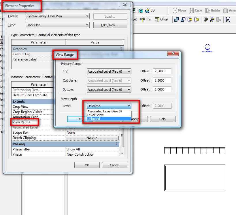

I've set up my levels etc, but my floor plan doesn't show in some views. This is making it hard for me to see where  I am building my walls. To explain, I have built
footing walls which are set from -600
start of facing bricks -150
ground floor level 0
dpc level 150
I started drawing my floor plan using lines in the footing walls view at -600 and the the trench block walls I have used show fine. I then switch to start of facing bricks view at -150 and I can see the floor plan that I was working from in footing walls view which makes it easy for me to build the two courses of brick I want for that view.
The problem is when I switch to ground floor level view at 0 because when I do this I no longer see the floor plan that I have been using as a reference from the previous views so I can't see where  I am building on from my walls.
Is there an easy way to rectify this?
Thanks, Kirk

in that view write VP then in the View Range change the View Depth...

Many thanks for that Typhoon! Greatly appreciated.
