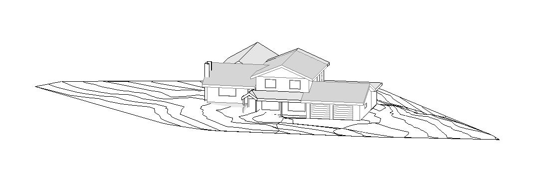

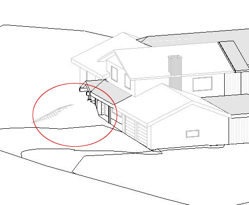

Here is a JPG of what I am trying to get done. How do you remove the topo down to the floor level so that the door and deck are not buried. Thanks
Wed, Aug 9, 2006 at 3:18:34 PM | RE: GRADED TOPOSURFACE AT RETAINING WALL
moxierawk
Joined: Thu, Jul 13, 2006
21 Posts
if the topo is at the right height hopefully it is if you took it from an imported civil drawing. it's a matter of what the house should be at for it's z height. Look at it in elevation and select everything you want to move up. Type in the new height on the datum. It's at 0. If your topo is poking through the building which in most cases it does unless you have a super flat surface, use the pad command under site and set it's height under the basement height so that way it blocks out the surface from coming in.
Wed, Aug 9, 2006 at 3:21:57 PM | RE: GRADED TOPOSURFACE AT RETAINING WALL
moxierawk
21 Posts
to make a better surface it is better that you have closed splines or plines. i draw it in autocad then give it it's z height. go through and do a laywalk making sur everything is closed and joined. that way seemes to make it the best and not have to bs it's topo like it does.
Sat, Aug 19, 2006 at 5:29:13 PM | RE: GRADED TOPOSURFACE AT RETAINING WALL
NewBe
Joined: Sun, Apr 9, 2006
28 Posts
Still trying to figure out how to do this. I tried the Building Pad but it doesn't alow any slope and shows a line in the drawing were the pad ends. Grading does work because it wants to slope everthing. I need a clean cut. I made the walls retaining but it appears to have no effect. Why are they retaining IF THEY DON'T RETAIN anything! Any more ideas? Thanks in advance for any help.
