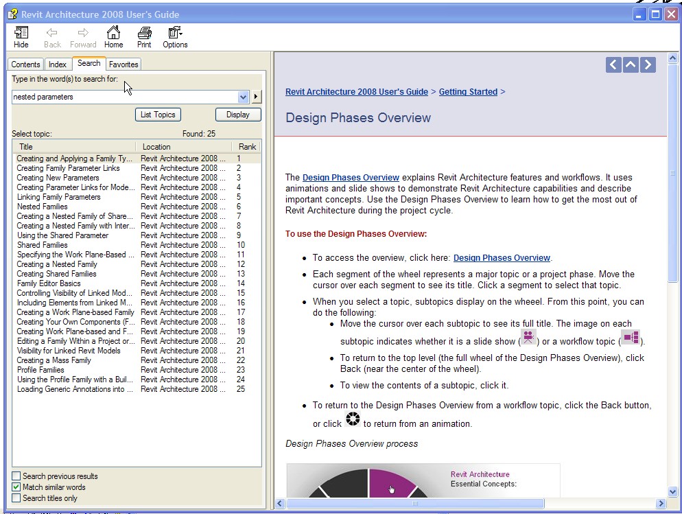

In your H E L P ,  check out "nested parameters".

"nested parameters" doesn't seem to be a category in either the index or search.  I did find  "nested family" and "shared family"
I've gotton it so I can tab select the subcomponent  while in the project (by checking shared in the "family categories and parameters for the family--However, I can't change any of the parameters (they are all greyed out)

Where are you looking? see screenshot!
Wed, Apr 22, 2009 at 4:06:25 PM | parameters for embedded families
Also check out this great tutorial from Mr Spot that walks you through this process ... and the tutorial was right here in the tutorals area:  http://www.revitcity.com/tutorials/arrays_and_nested/
