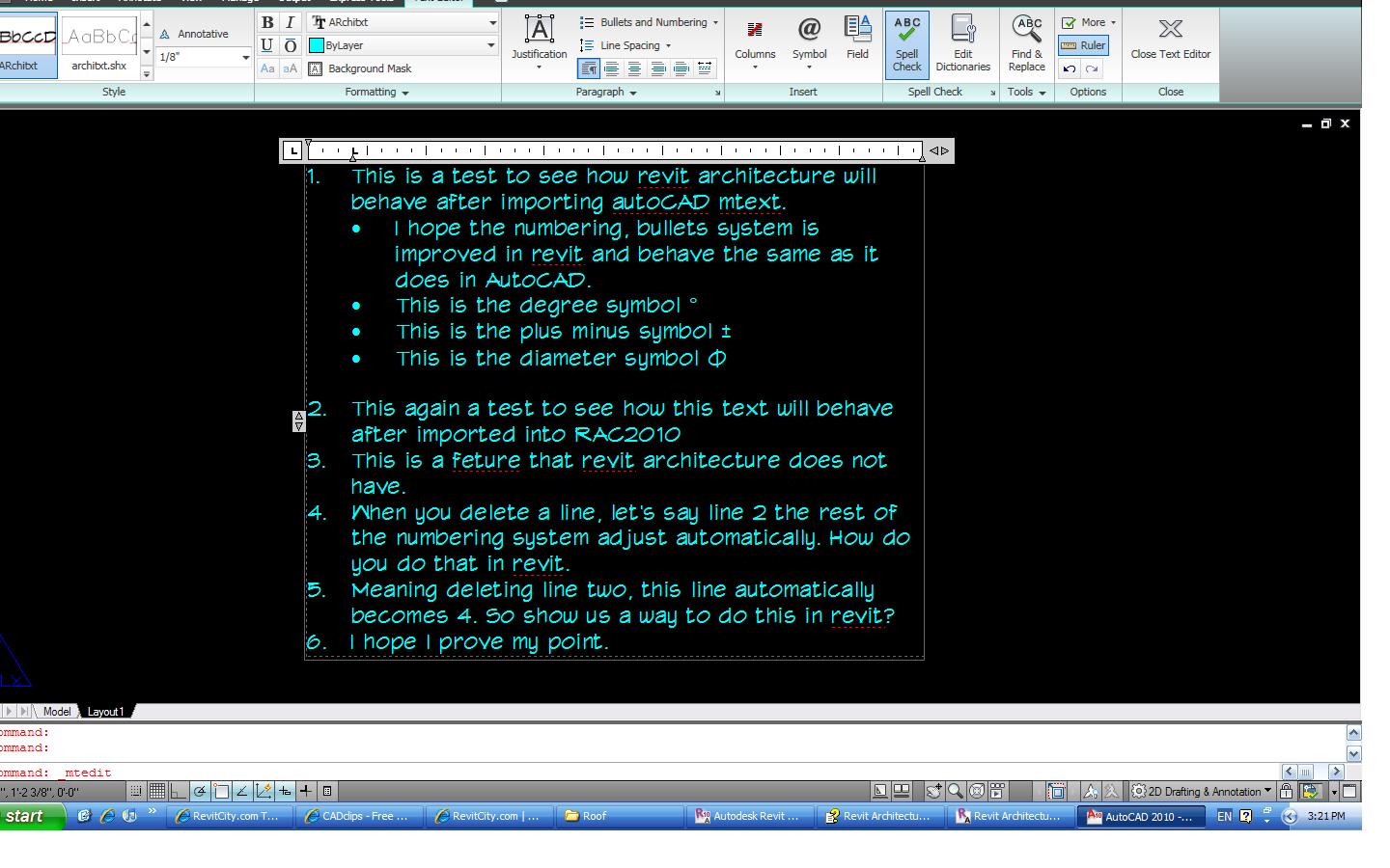

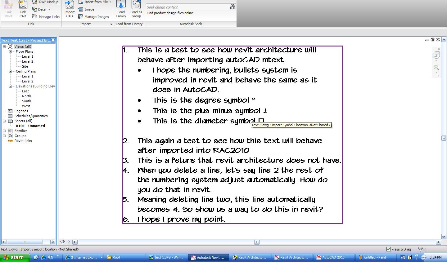

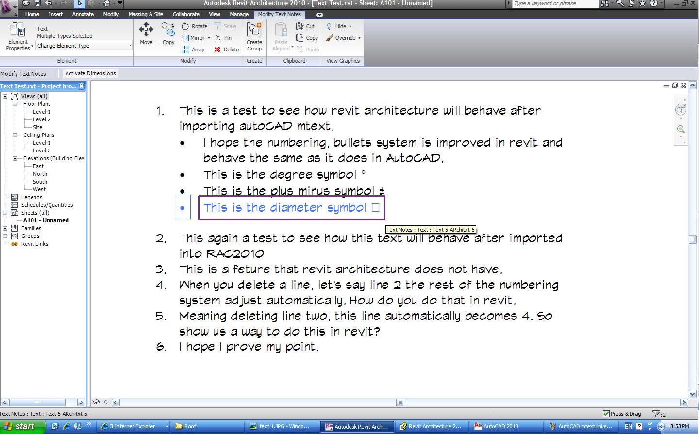

I was trying to save the rvt file I sent you earlier as an earlier revit version but it is not possible. I'll see if I can figure out a way to send you the font. But if you look at the images below you can see the text I use and if you have it already let me know if you dont I'll find out a way to get it to you.

WWHub,
So. you say "REVIT's notes are 100% easier to do then AutoCAD's!" How do you use bullets or numbering system in text box with several paragraphs? How do you insert a left or right indent? Please see the images below.
Thanks

jaff, I said notes - not text editing.  nooneuknow was asking about notes "with leaders".  That is a much simple process in REVIT than it ever was in CAD and the notes are associated with the leader!
BTW - AUTOCAD's  mtext will not import as multiline REVIT text.
Why do you expect a shx font file's import symbols to be recognized as the correct symbols using a TTF file?  There was no standard for shx files.  Use a TTF in CAD and import that.
