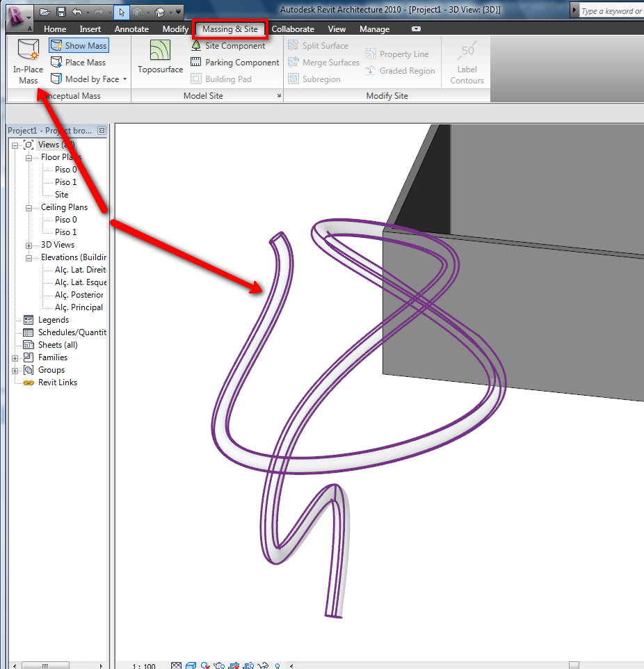

No, if you use the "Create In-Place" you have the old forms (extrusion, blend, sweep...), you can do that directly in project using the "In Place Mass" or in the Families and "Conceptual mass"

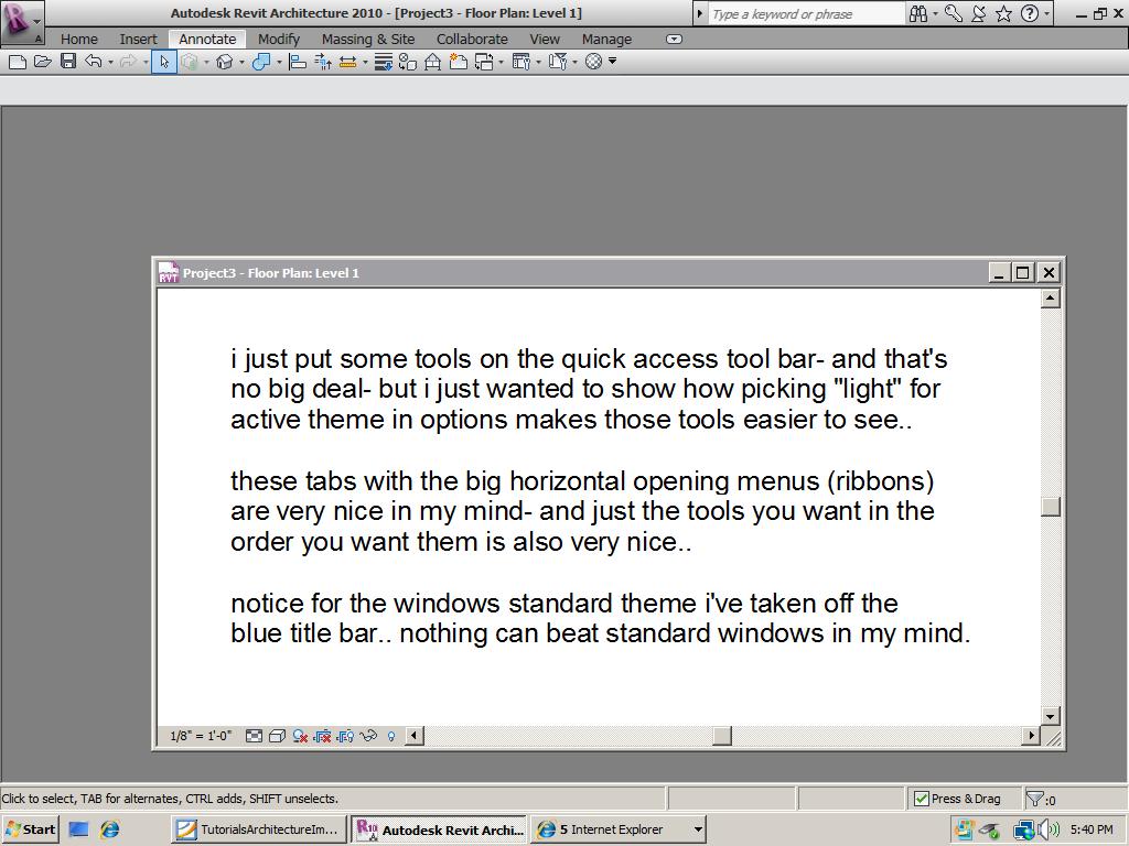

Thu, Jun 4, 2009 at 7:44:06 PM | [Revit 2010] Mass form usable as generic model or any structural element?
WYS1WYG
WYS1WYG Avatar
Joined: Sun, Jan 4, 2009
356 Posts
3 Stars: 11 Votes
check out this screen shot..
