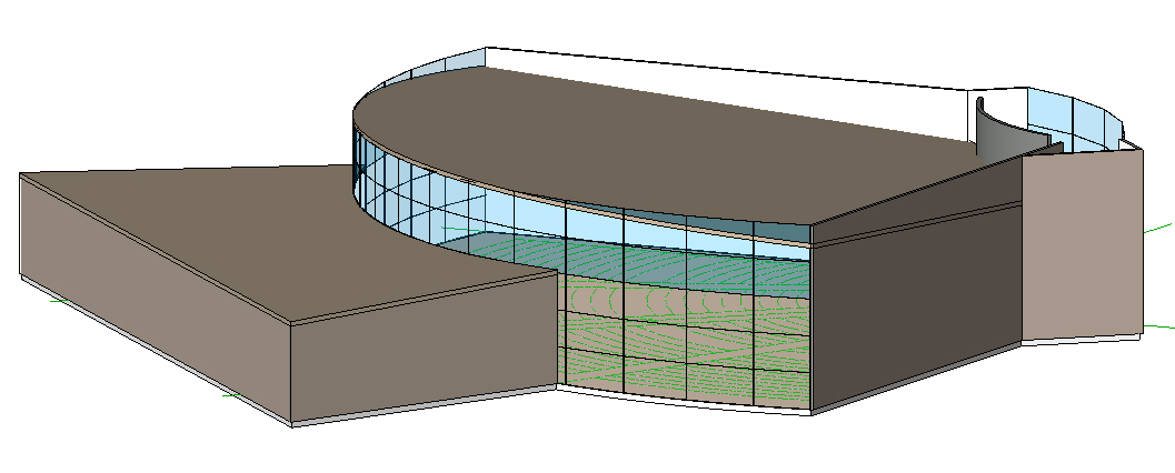

I am trying to attach a simple shed roof to a curved curtain wall. I drew a roof by footprint but when I try to attach, I get the error "can't keep wall & target joined" Any help would be greatly appreciated.

adding an image to show what the problem is

Click on the curtain wall and set the top to attach to the roof.... It will edit the profile of the wall automatically.  Make sure the roof extends over the wall all the way.

Thanks for the help, I guess since I had the roof print end at the edge instead of a overhang that was causing all the problems
