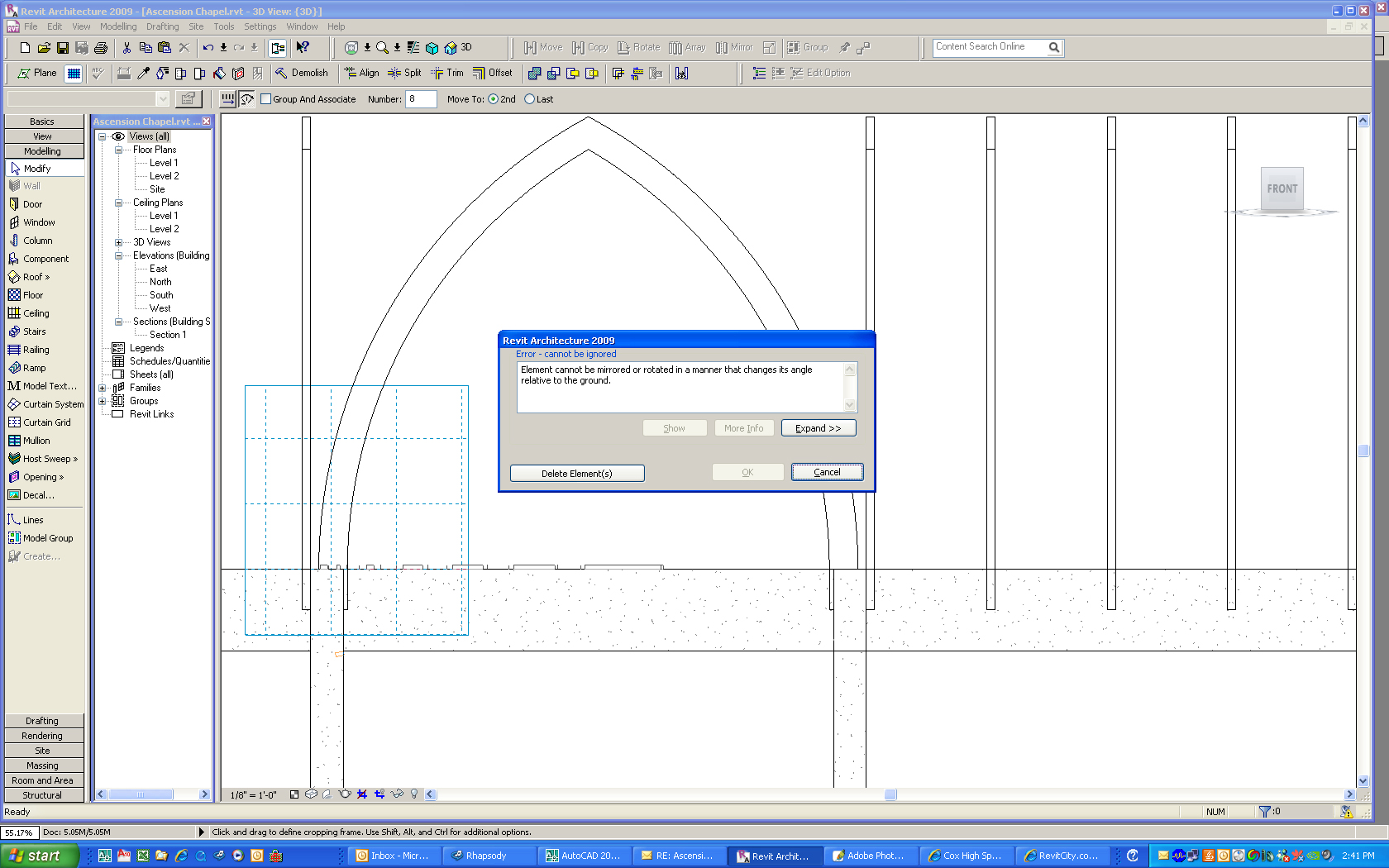

5. now what I want to do is make an array that will copy this object in a circle on a Y axis with the object.  To get a better visual say you looking at the small end (the 2x4 - its in elevation now) and its at the 3 oclock position on a the clock and I want to array it around the center of the clock.  So I set the working plane on the 2x4 end so the working plane is flipped form the plan plane to Z plane or elevation plane.  I select the object, and pick the array command and pick a point  and begin rotating, but when I click to finish the object it makes the array in the plan view not the Z plane  (or elevation) view. It gives me this: Element cannot be mirrored or rotated in a manner that changes its angle relative to the ground.

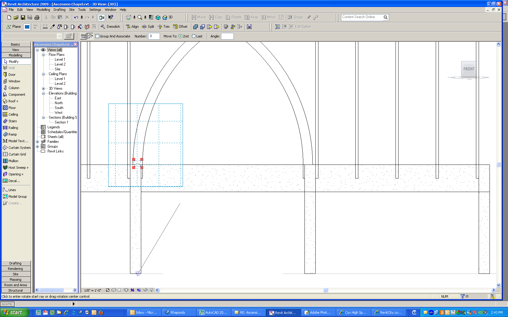

ok, the first image shows the location of the center of the array - its not where I want it, so I move the rotation center point to where I do want it (see second image) and when I array the component doesn't array in the workplan, but in the level 2 work plane.

I see the error message, Im not sure how to create a component that will allow me to load it in and array the way I want.
btw, its hard to see, but in the first image im trying to array a small rectangular wood purlin around the perimeter of the glulam arch.

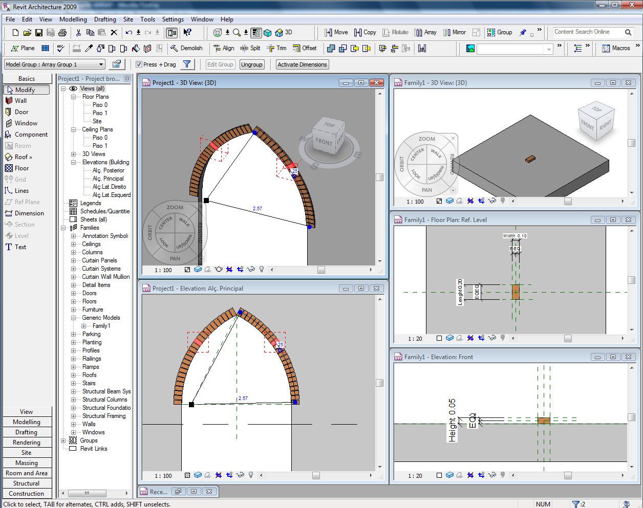

What i do is create a "Generic Model Face Based" so in this way in elevation view i can put the Object attached to that face, then create the Radial array like you can see in the images, i don't know how it's the object you try to do, but, if you create a generic model you can only attached to the plan level, and you can array them unless in the plan view where you "insert" the family, that's why...

aaaaah, I see in your brick arch you are doing basically the same thing.  So to do this I need a "face based" family, and I suppose I should create it so that the end of the purlin is the plane I want to array in - correct?
