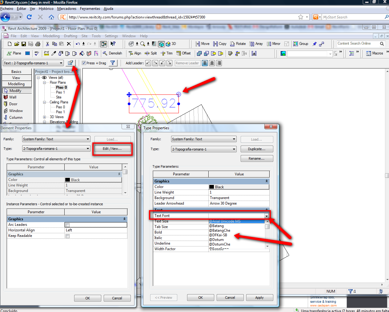

So, after you explode the dwg pick in one font, then with the right button of mouse, "Select all instances" then go to the properties and change the font you want like you can see in the image attached...
