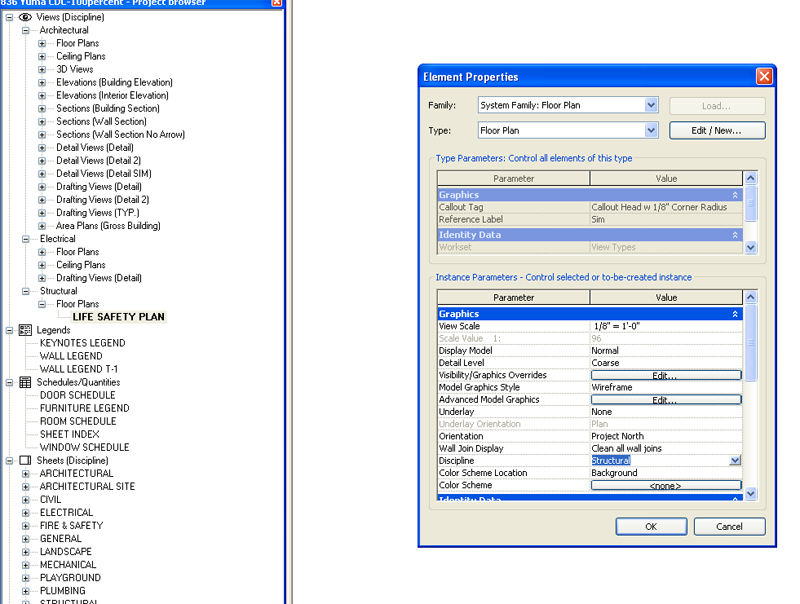

I need help, I had created couple Sub folders of Discipline But now i need to create couple more i cant. I right click on the floor plan and properties and under Discipline wont let me add any, only let me select from a list. I attached a picture tp should were i am when i do this. Am i missing something? or is there a place to create a new Discipline for the list.
Help, i have to get this fixed today.

I want disciplines, there is Architectural, Electrical, Mechanical and Structural. But i need to add Fire & Safety, Landscape under the Views. My Sheets are ok.
I already have my browser filtered to the disciplines. Its i cant add the others(Landscape, Fire, etc.) to it. I want to keep the Views for each seperate, so im not having to scroll through so many.

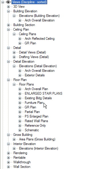

You can not add disciplines... but if you look at what I posted, you can add sub items to your views so that you can sort them... If you want the answer on that - look in the forums using browser as your search.
