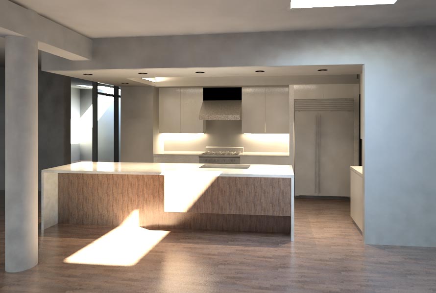

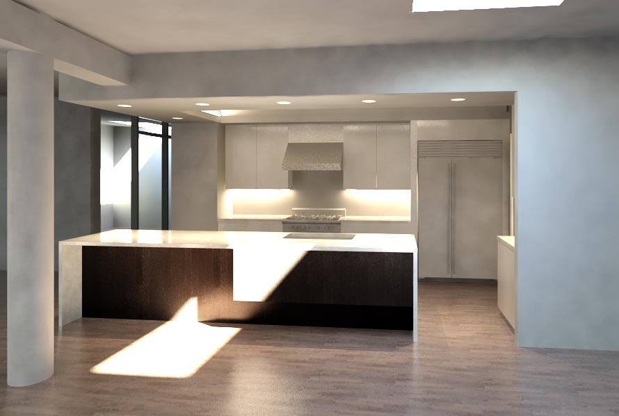

I've read all the threads and tried downloading the patch per typhoon's post last year (but it wanted me to unload my current version 9 and i don't have the time), but nothing works.  I render a scene and the cans look great.  I render the same view, the cans are black holes.  And now I can't get the cans to light.  I am happy with the level of lighting, but is the self-illuminating material the answer for the black cans?
Wed, May 13, 2009 at 10:21:14 AM | Interior Lights are not working in Rendering
jprado
Joined: Sat, May 2, 2009
42 Posts
see cans in the soffit above the island counter

I've had the same problem. The recessed can look fine when rendered under Artificial Only. But they go black after rendering with Daylighting and Artificial light. The strange thing is that they're still working... I guess the work-around is the glowing material, but it does make me wonder if something is not set up right.

Try to increase the Wattage of those lights, multiply the watt by 100 and check

I found that happened for light fittings I had copied from another room for example, but not when I inserted them as components - then they emit light as expected.. I have no idea why this shoud affect things though
