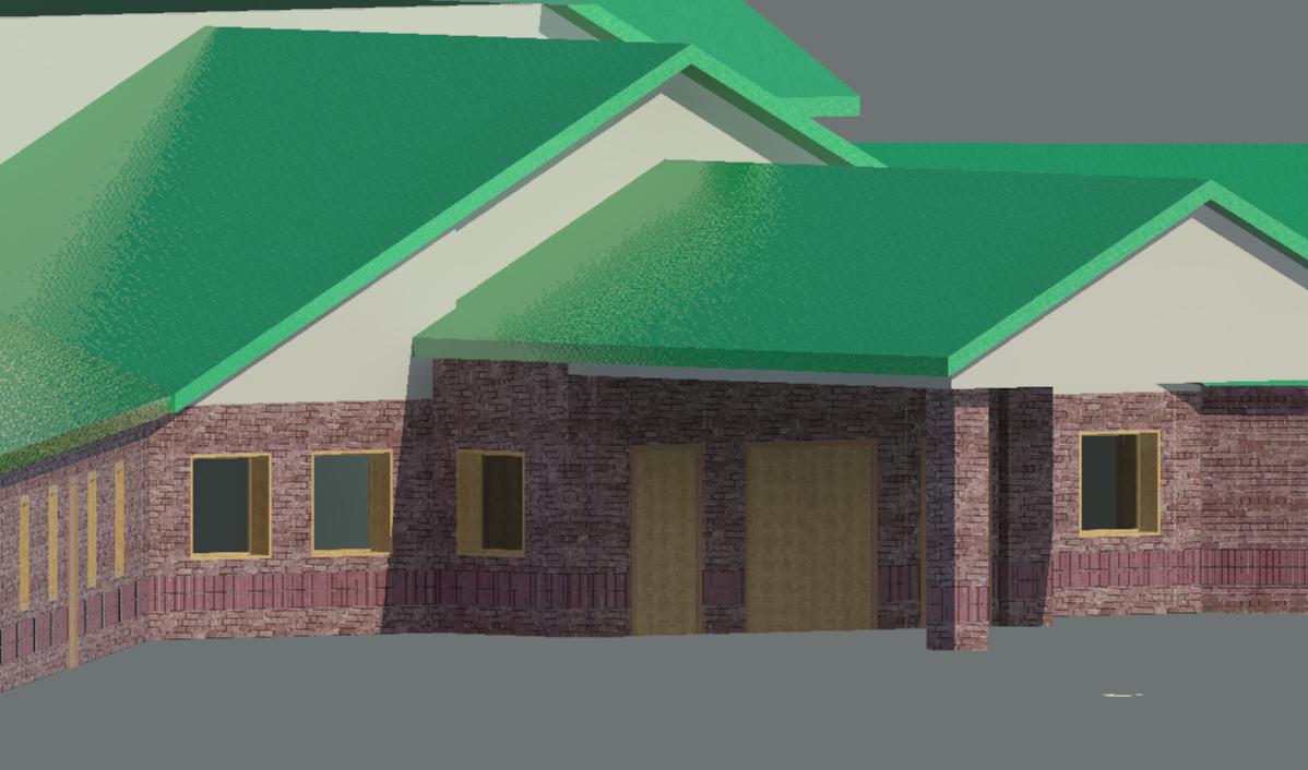

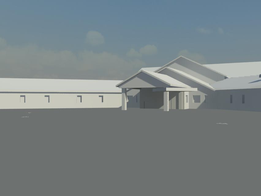

The question was in the chatroom - the poster says the file will render from a plain 3D view but not from a camera view as shown by the attached views.

Could it be a phasing issue.  Try copying the phase of the 3D view in the camera view.
