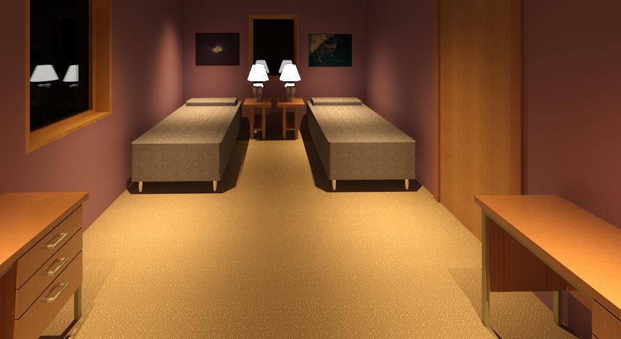

ok video card is your preference i have an ATI Radeon HD 2600 Pro with 512mb dedicated ram. I am running 4gb of ram on an INtel core 2 quad core processor. You could upgrade to the Intel core I7 which is the best on the market but carries a price tag. The processor is the key for shorter rendering times. I would actually advise running Dual displays if you could like two 19inch. The video card above works great for modeling doesnt skip a beat and has dual DVI outputs. Basically get at least 4gb of ram and a quad core or better processor and you will be fine. This setup works GREAT for revit 09 but i dont know about 3d max but it should be fine. The picture attached took about 22 minutes to render on best quality with 6 interior lights.
 ^Fyi you dont need 8gs of ram that is not true probably a typo. I dont even know of any pcs that run that much.
