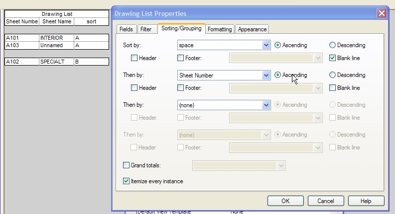

Is there a way to add a blank line to a drawing list?  For example, we like to have a space seperating the floor plans from the elevations with a blank line (A100 Series and A200 series etc.) as well as elevations from sections and so on.
Thanks for your help!
Wed, Apr 15, 2009 at 2:42:34 PM | Can you add a blank line to a Drawing list?
Sorry - I jumped in too quick ... add a parameter - I called it sort , instance based... sort by it and hide the column - check the box for blank line and this will work.

Great! That should do it... thanks!
