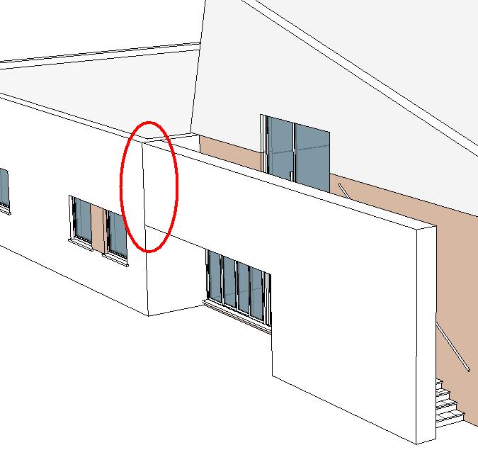

I created a 3D view for my project. I want to make a edge between two walls invisible with the linework tool. But the linework tool makes the entire edge invisible and not just the part where the two walls connect. Is it possible to make just a part of an edge invisible?

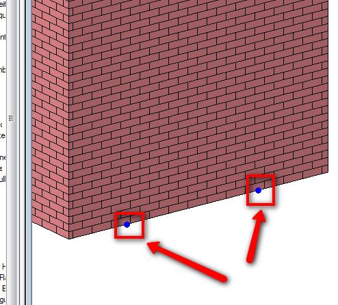

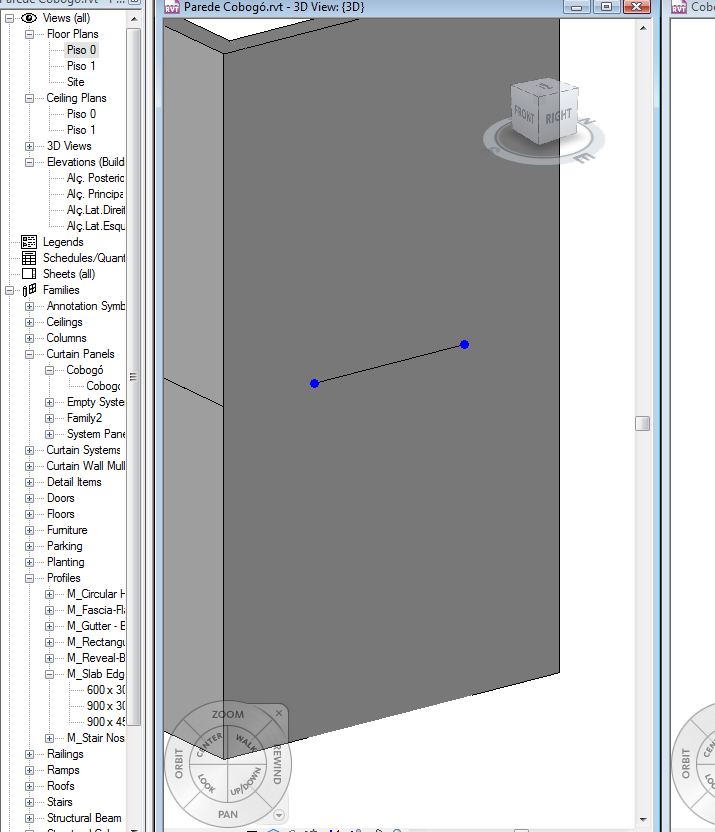

Did you try when you use the linework tool, drag those blue dots where you want???

here you can see better....

Thanks. This helps in normal 3D views. But it doesn't work in 3D views with perspective (camera). Is there a work around to do this in perspective views?
