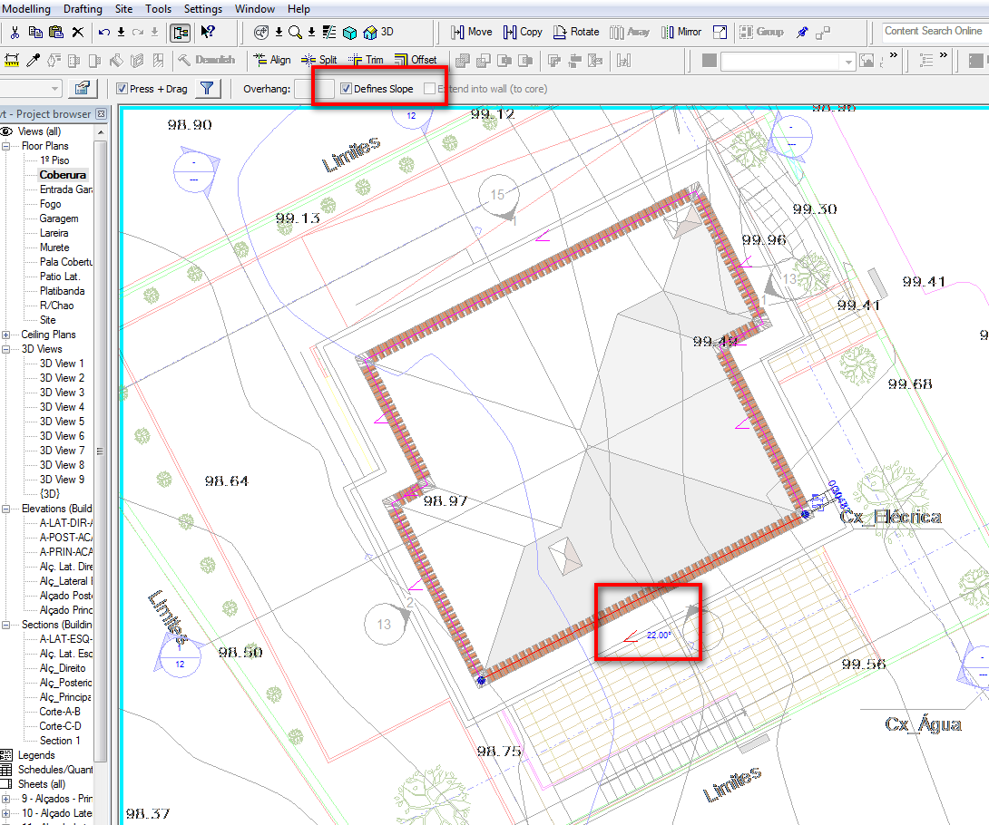

When you are in Sketch mode of the roof, you can define what lines you want with the slope, if this is what do you need....

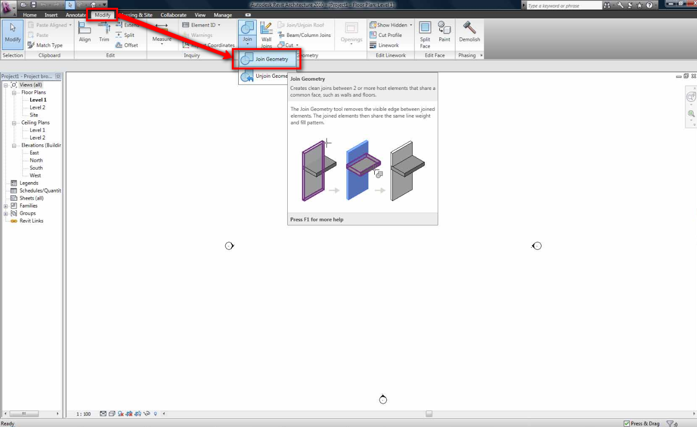

ALEROBER, what do you mean with "I cannot connect them at the corners to make a continous roof"?, join them?, if so, have you tried with the "Join Geometry" tool, but it would be easier if you post an image of your roof?

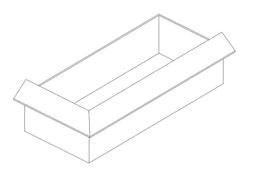

I attached my problem this is an example but i can not get the corners to join even with jon geometry.  Please let me know if anyone ahs any solutions.

Here is the attachment I hope. It shows it in the attachment box.

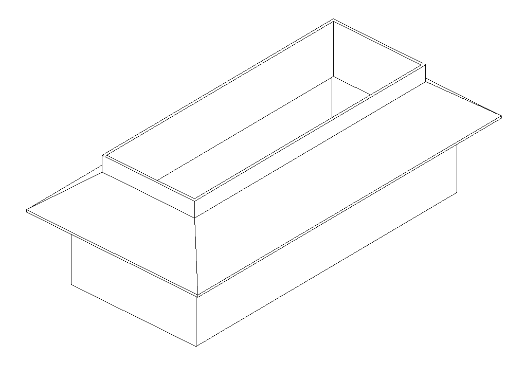

okay I was sending to big of a file but io think i got it here it is.

Hi ALEROBER, sorry but, is this what you want?????.......

yes thats exactly what i want please tell me how you did that I've waisted countless hours trying to figure this out.

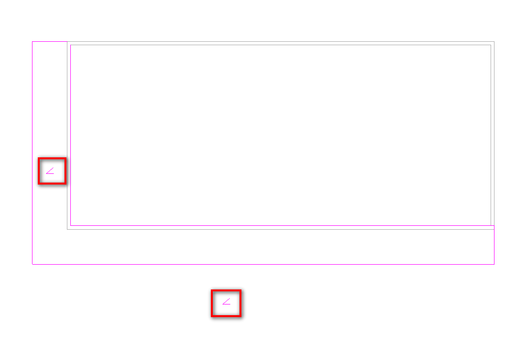

ALEROBER, what you´ve been doing incorrectly is that you are sketching two separeted roofs, you can do that roof in only one sketch (see images). I recommend you consult always your HELP menu.....

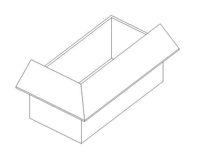

Ok im half way getting it now but I can not get the whole roof to go around and im still having problems getting the inside of the roof to be vertically flat like a parapet.

ALEROBER, as I told you before, it would be better if you post a kind of image in order to understand exactly what do you want...I suppose that you want somethig like this (image).....
