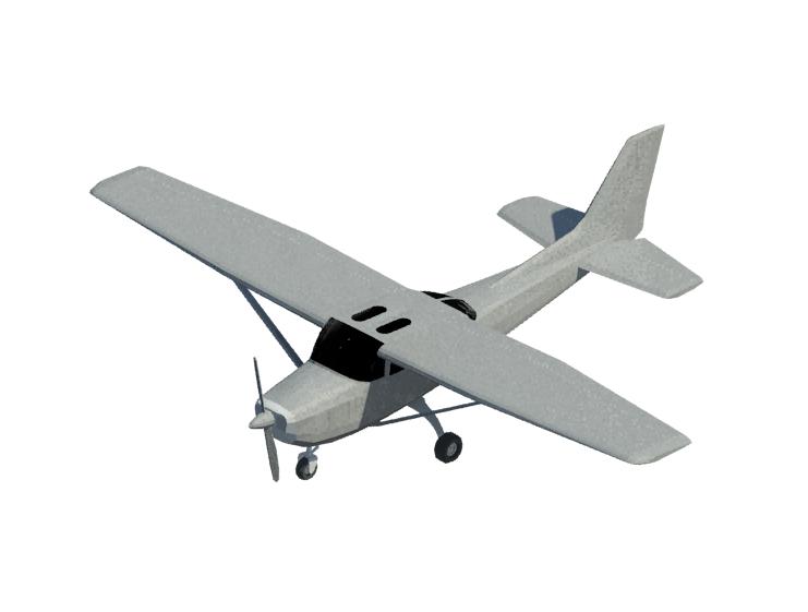

would someone be kind enough to tell
me how to render this plane anything
other than gray? i downloaded it from
revit city..
see attachment..

Try to edit the family then go to settings>materials and check if that plane have several materials, if so, edit them and change the materials like you want, save and load into project...
This model was made in 9.1 version, i think, so the material you have there are from Accurender, now, with the 2009 he don't recognize those materials, so you must change them to the new ones....

Hey man, why don`t you try with this one?.....http://www.revitcity.com/downloads.php?action=view&object_id=6198
