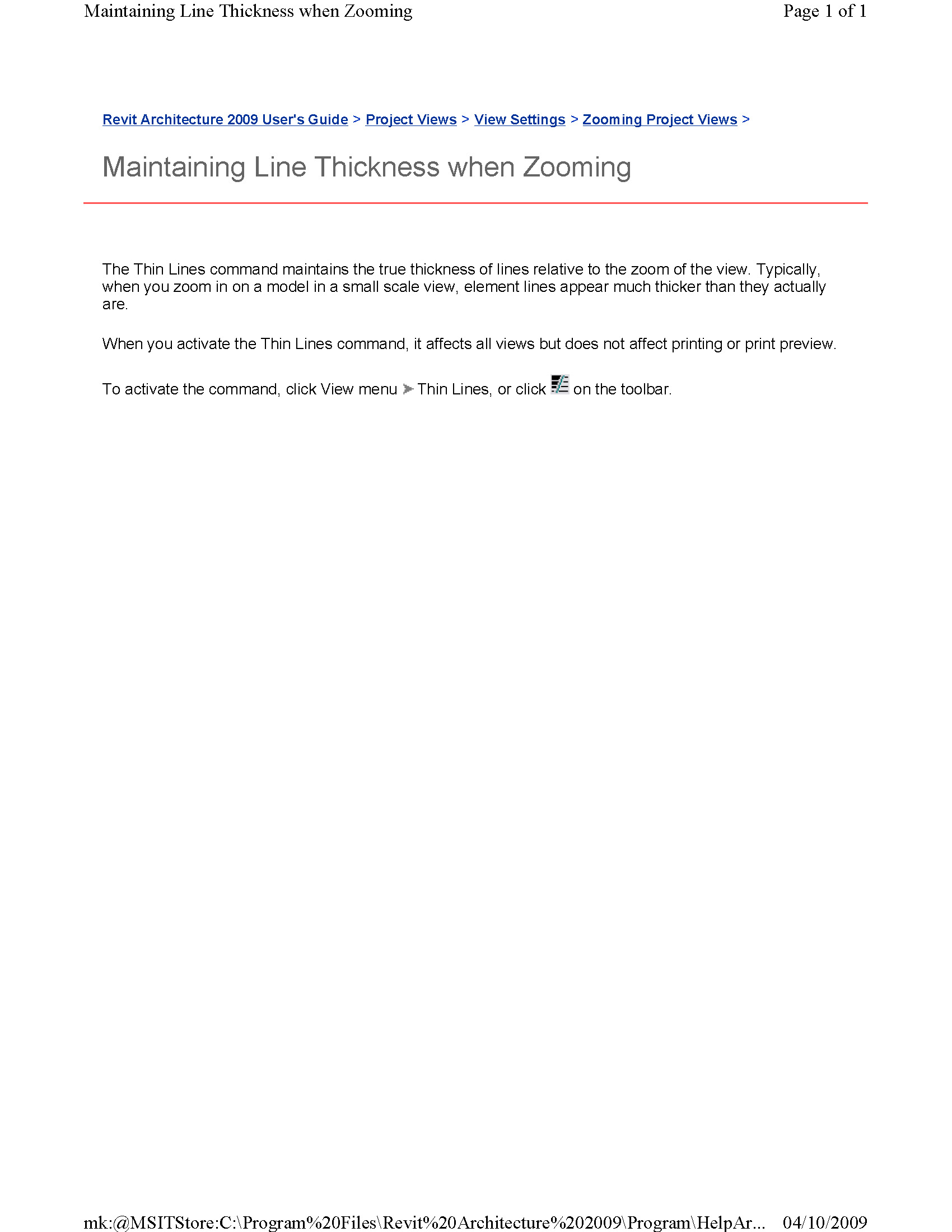

Hover over the tool icons and find two tools for me: linework and thin lines.
1. Footings: This is where i use the line work tool to make my footings hidden line.  Cryingor you can select the footing and right click > override graphics in view)  You can select the type of line you want and and modify the footing line.
Revit is supposed to have the ability to show objects that are in the lower portion of the view depth as hidden but i've never been able to make that work just right.
2. Now click the thin lines tool and Revit will darken wall faces, detail components, etc. These settings are in the object styles settings. I don't mess with the OS too much but i bet there are others that have it set up to a tee. This is something you would set up in your template so that project after project it's the same.
Like WWHub was saying, something you handle on a view by view basis...some you set up in your template or project. I'm not nearly as experienced as them so I bet they'll have more and maybe better input.
