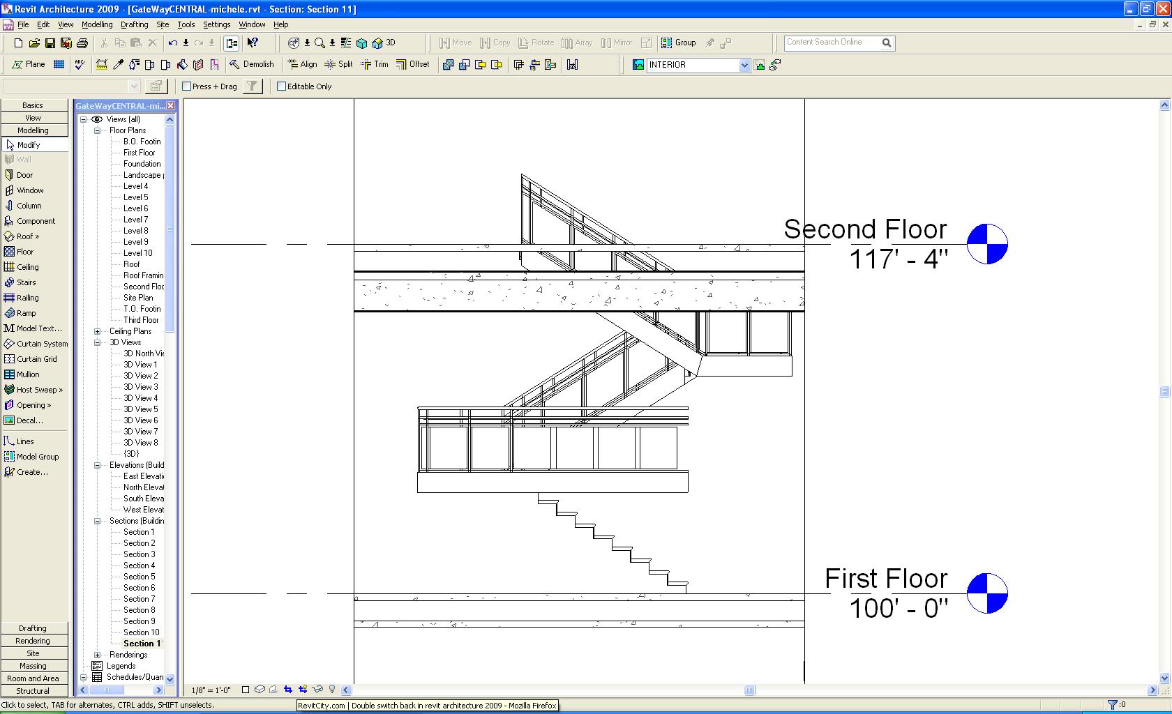

I am trying to make a stair way that switches back twice from 1st floor to 2nd floor.  I need 30 risers, so i do my first 10 then make my first switchback to the next 10 risers when i make the second switchback it will obviously overlap the very first run and thats where i am having errors. When i make a section cut and look at a side profile of the stairs the top 2 runs look fine but the problem is the first run. The side channels for the first run are connected to the first landing and not to the stairs themselves. Sorry if i made this too confusing. Any tips would be very helpful.

It's sounds like you must do that in two parts but can you please put some images of what are you try to do????

hopefully this helps

You must do that in two parts because if you try to do in one time you "overlap" the lines of the stairs, they are one in TOP of the other Right???

yes, would you recommend making a new level and then do two separate stairs then?

Yes i Do.....
