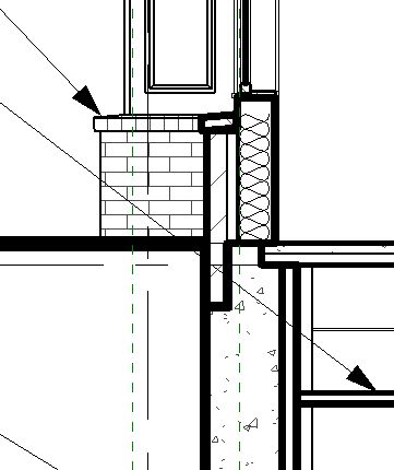

I have a 20 inch foundation wall that needs to have a ledge on the exterior for batten stone and a ledge on the interior for slab bearing.  i'm able to create the ledges using the stacked wall but my issue is that the ledges are different depths.  What is the best method to create such a wall profile?

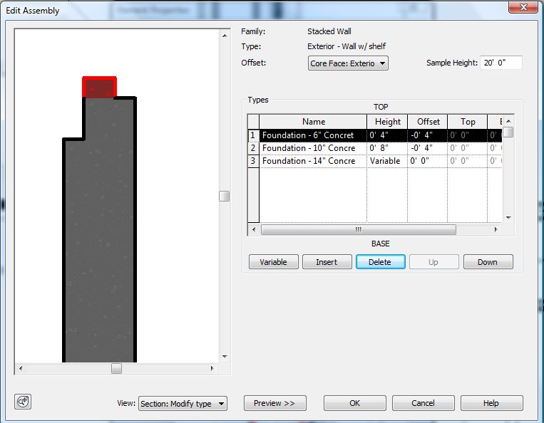

I have done this with three wall types stacked.  You would just offset them the appropriate distance.  I attached a few images:
1.  Shows the finished wall
2.  Shows the stacked wall dialog box
Let me know if that doesn't explain it clearly enough and I can give you a verbal explanation, but  this should get you where you need to go.

Thanks!!  That's exactly what i needed.  i'm pretty new to Revit.   Didn't think about adding that extra wall.
 Thanks again.
