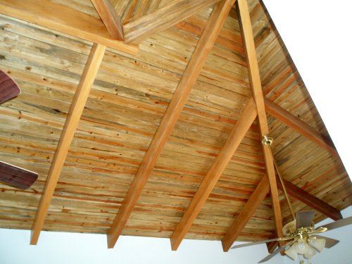

I'm trying to create an open beam ceiling. My finish roof is spanish tile. Can anyone help me to create the open beam ceiling. (See attach photo)

Under your structure tab- there are your beams to use to support your roof. I'd suggest using F1 on a step by step process on building this correctly.

Use the roof but with "Sloped Glazing", i did post in the past some videos with this same issue...
I found one of the thread with this: http://www.revitcity.com/forums.php?action=viewthread&thread_id=14154
