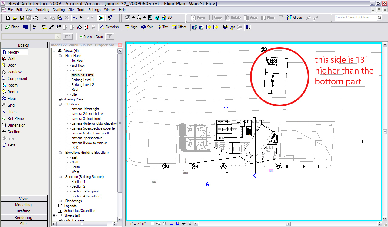

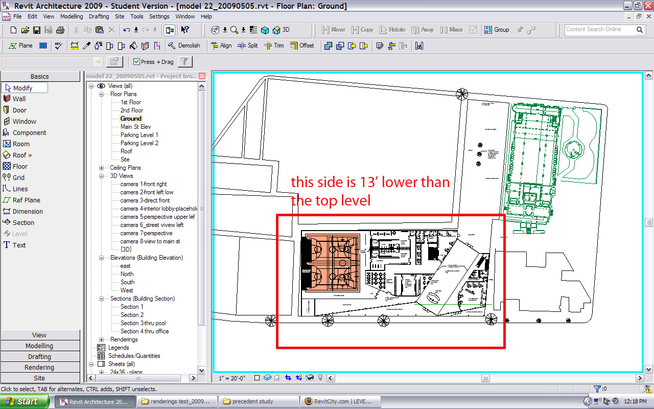

hi, i have a related question. My site has a grade change. The bottom portion is at 0' and the top portion is at 13'. So is there one building on the bottom, a plaza in between that will have stairs for the grade change, and a top level. how can i get the 13' level plan to appear in teh 0' level plan? i feel like its confusing having 2. see attached

VIEW>PLAN REGION
Draw your sketch and set the properties and you should have it.

thanks! that made sense. u draw a "plan region" and put the level that u want to appear under view range in the properties list.
