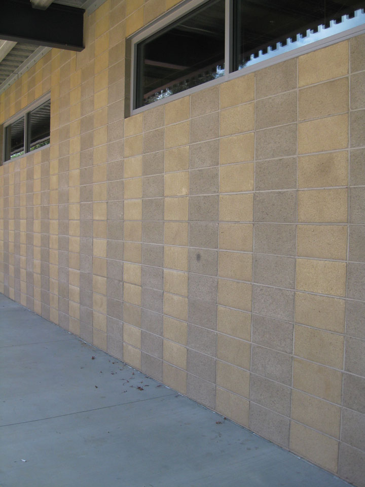

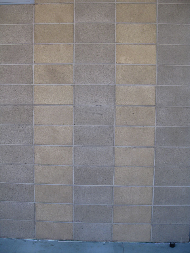

Sat, Apr 11, 2009 at 1:03:39 PM | One wall two different paints?
adlcdg
Joined: Mon, Apr 21, 2008
8 Posts
Here are the pics.
Sat, Apr 11, 2009 at 1:19:05 PM | One wall two different paints?
Joined: Tue, May 22, 2007
5921 Posts
4 Stars: 205 Votes
Well, why don't you use only a texture like that???? you don't need to split the wall...
Sat, Apr 11, 2009 at 1:51:53 PM | One wall two different paints?
adlcdg
8 Posts
Thanks for  your help
