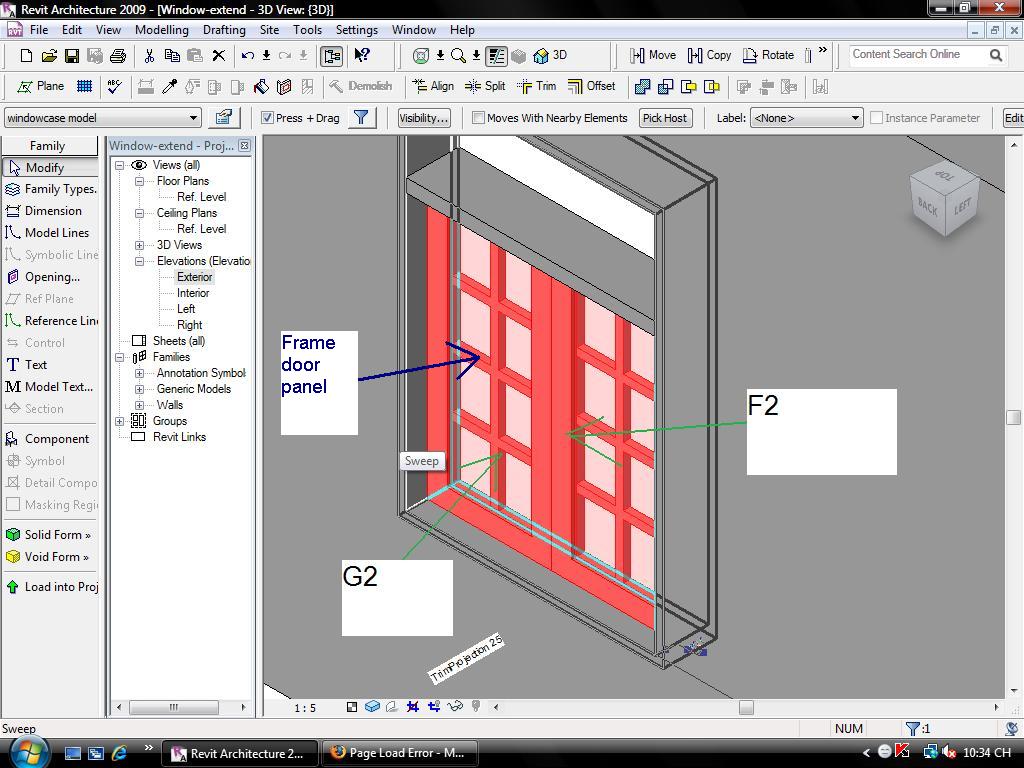

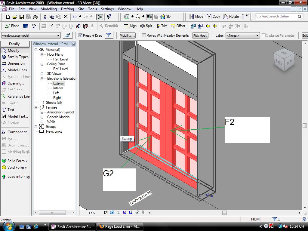

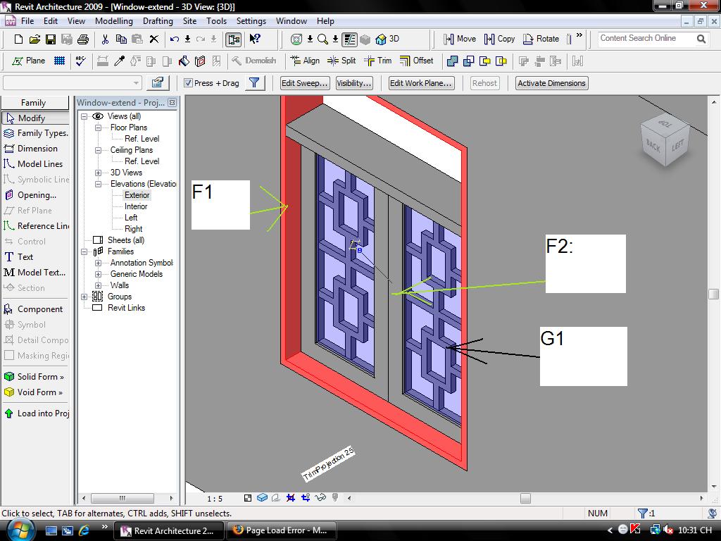

I using Rac 2009
I created 2 generic model family (I call :G1, G2 )
I create Generic model family (I call F2) and loaded G1, G2 in F2
I create  Window family (I call F1) and load F2 into F1
I open new project anh load F1 into . I see G1 graphic but i want choise G2 . I must open F1 and change ang load again to project !!!!! . How do change G1 to G2 direct in project ? Help me !

Your best option would be to create a Yes/ No visibility parameter. this will allow you to toggle between showing g1 and g2.

Thanks .
I sucessed creating this one . Family is interesting !
