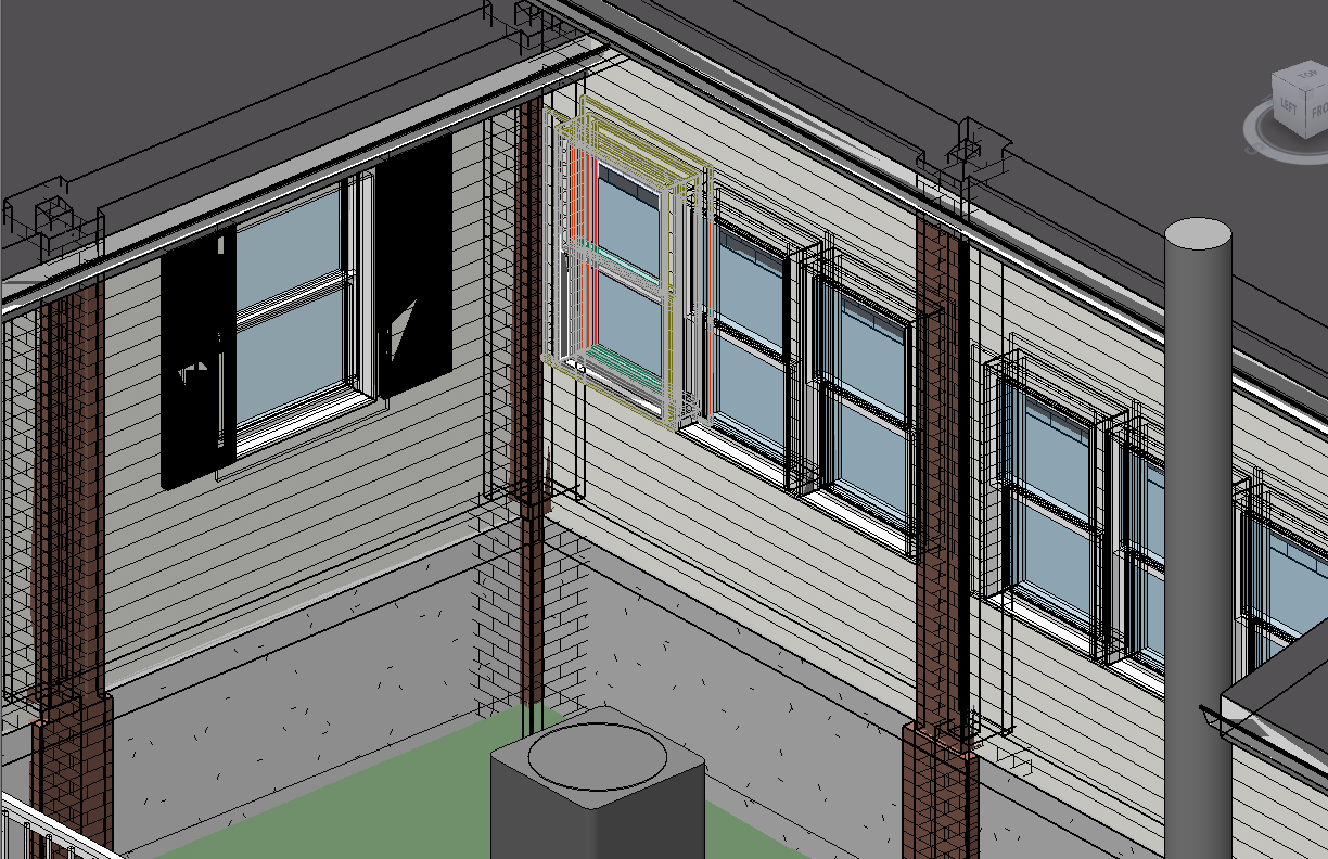

I keep running into a problem any time I make even slight changes while in the 3D View.  In both the shaded view and the hidden line view I get lines that should be hidden within the building which get progressively worse as I work in the file and eventually the entire view becomes wireframe.  Most of the time I can close Revit and reopen the file and it is back to normal, all lines which should be hidden are hidden, but I very quickly run into the same issue again as I continue to work.  This happens regardless of the detail level setting.
 Any ideas here?

Delete that 3D view and create a new one....

Thank you!  That worked perfectly.
