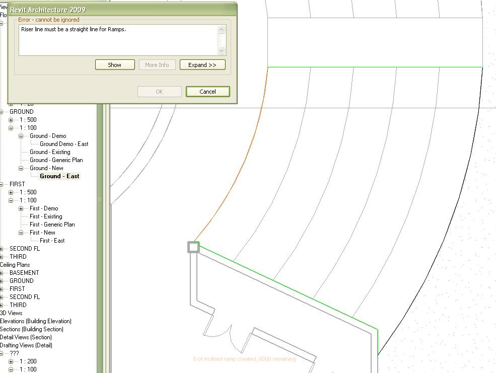

I am currently working on an Auditorium plan in Revit Arch 2009 and need to add the seating area.  The area is in an arc shape and i need it to slope from the ground floor up approx 2 feet.  I am trying to add in a custom ramp but every time i try i get a message telling me the risers must be straight lines.  Does anyone have any sugguestions on how a work around for this error or another way that would be possible to create a ramp for this plan?  Attached is a screen capture of the area that i am working with.  Any help would be greatly appreciated.

You can only have straight risers when working with ramps. You are going to have to make them out of stairs or use a mass to make it work.

This area can be created using a sweep, or sweep blend if you want the end elevations to change. The attached is a method for developing streets and should work for this application.
