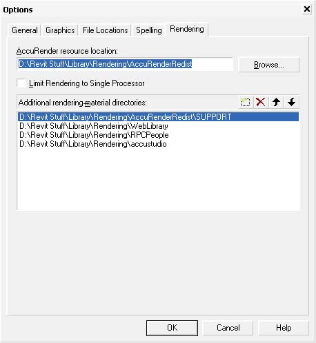

Hi All, After installing off-line the demo version of revit 8.0 downloaded from Autodesk web site (content and libraries in the suggested directories, specially AccuRenderRedist in C:Documents and SettingsAll UsersApplication DataAutodeskRevit Building 8RenderingAccuRenderRedist) starting the program it return the following error message: "the AccuRender rendering feature is not available because the AccuRender material library could not be found on your computer. please check the Accurender resource path set in the Setting/Options..dialog". In which directory is the "AccuRender material library"? In the dialog Setting/Options there is under the option "additional rendering material directories" another path "CPuhrogrammiAutodesk Revit Building 8DataMaterials". Can the error message to be caused by a file not found in this directory or by wrong pathname? Sorry for my little English, thanks in advance for Your Help, Andrea.

The Rendering location at the top should always refer to the AccurenderRedist folder, addtional libraries should refer to any folders containing "plib" or "mlib" files plus any rpc content you wish to use. HTH.
