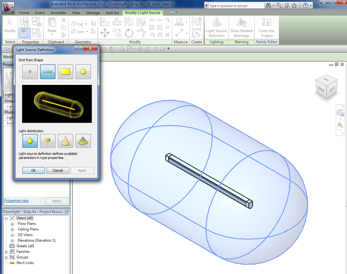

Select the light and on the properties palete, for "Light Source Definition" click Edit, then for "Emit from shape" click on "Line" and for "Light Distribution" select "Spherical" (not HemiSpherical), now render in "Medium" quality and check if this solve your problem.

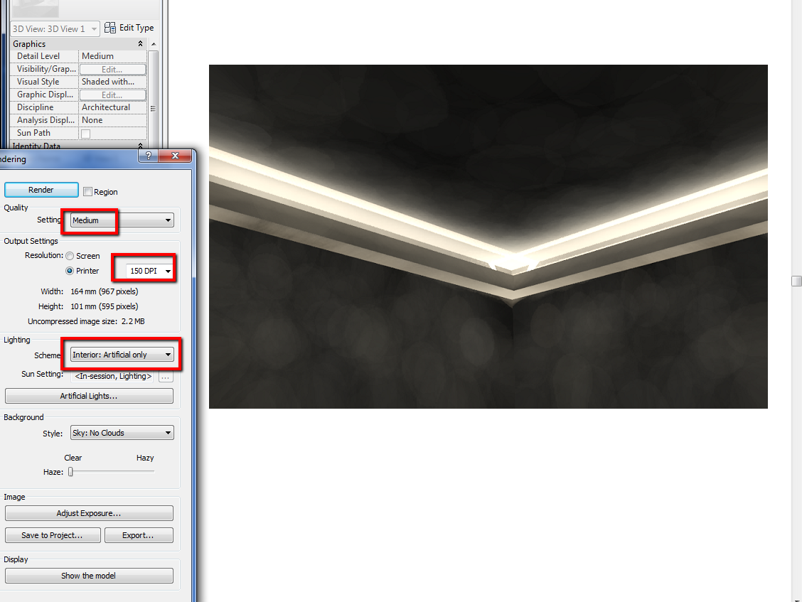

There is also the possibility that the rendering settings are too low, medium and higher settings are needed for lights to render correctly at their sources, if I recall.

Medium is enough to check if the light is working.
