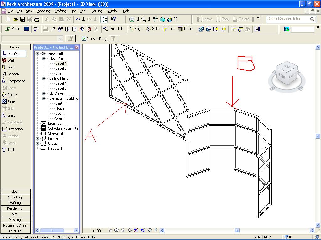

Trandung, you can give angles to your Curtain walls grid lines, pick in the curtain wall, go to the properties and can see the angle to horizontal and vertical grid lines.... check the HELP menu....

Only change angles in straight curtain system , Curve curtain system can not .
