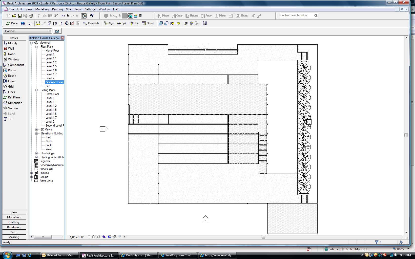

I haven't been using Revit but for only an week and have made great progress with it but now I have hit a road block.  I can not figure out why things are showing up above the plane cut line.  I did not have any problems with this till I started working on my second level.  The design was done completely using Revit.  I have messed with the plan view but I can't figure it out.  If anyone has any recomendations it would greatly be appreciated.

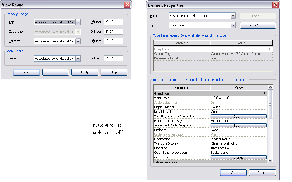

what is specifically showing up? The picture that ive attached shows the default settings for the view range.

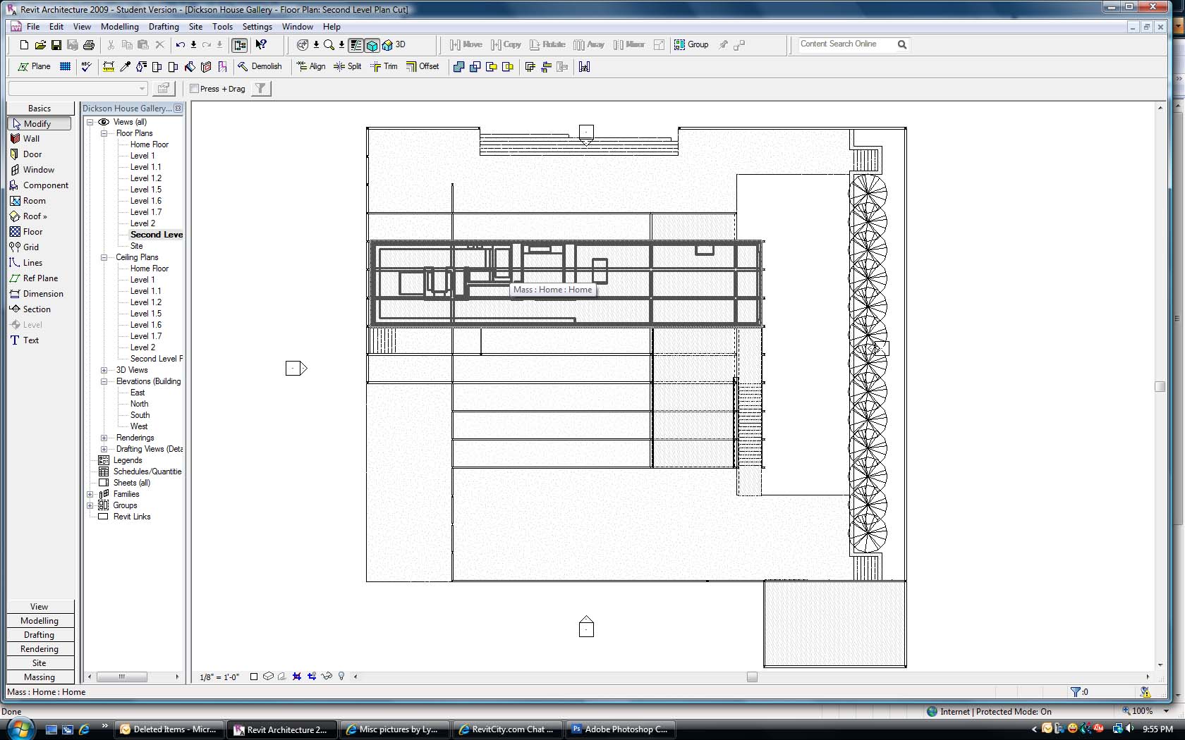

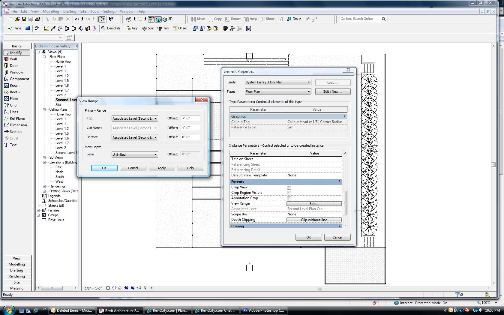

This is what I am seeing.  The lines that are appearing when I mouse over is what I am supposed to looking at but the ceiling and roof are in the way.

Make sure that you view depth is set to associated level and not unlimited.
