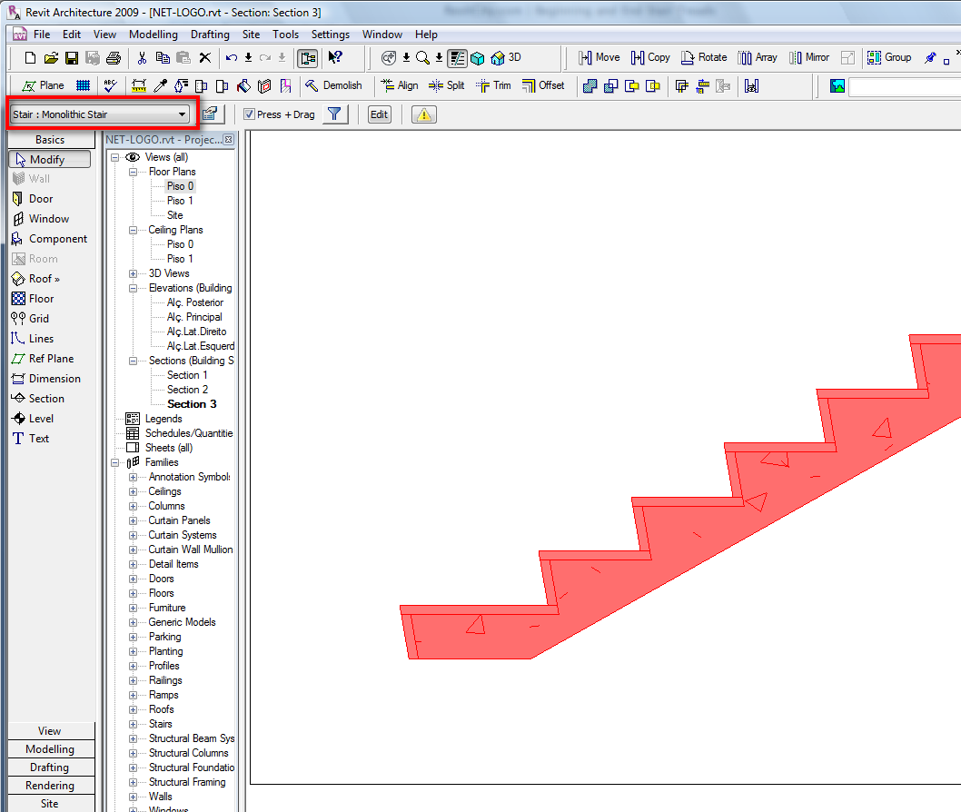

 I was wondering if Revit allows you to make different length treads for stairs, particularly the beginning and end treads. I am attaching a sketch showing sort of the idea of what we're trying to accomplish.

Yes, and its very easy. all you need to do is modify the riser lines ( black lines not the green ones) that create each tread.

Create that by "Boundary and Riser" if you want....
