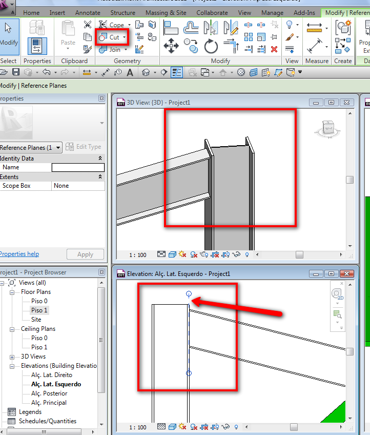

"How do you have revit cut a section at a sloped joist, bearing on a beam, joist girder etc. and have it show a little more accurately in the section."- Create a ref. plane then use the "Cut Geometry" tool to cut the beamto that ref. plane

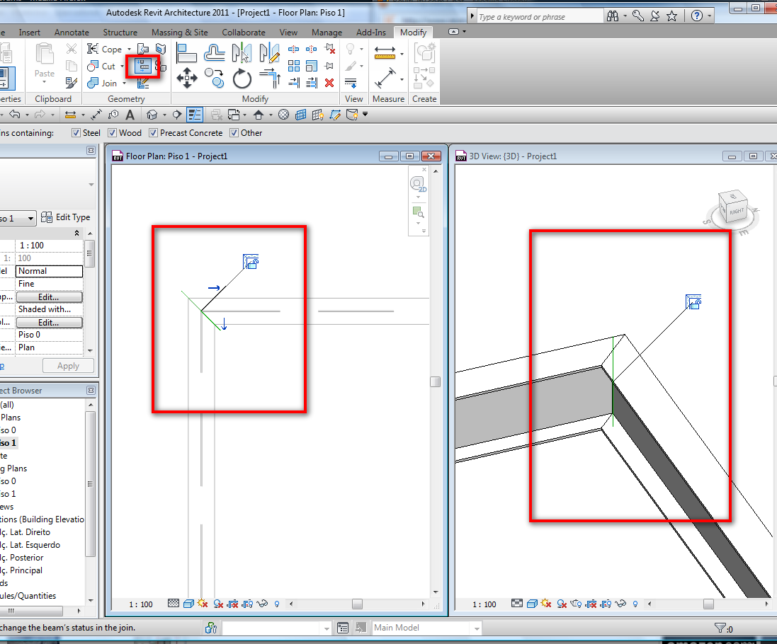

Also use the "Beam Columns Joins" like you can see in the image i attached

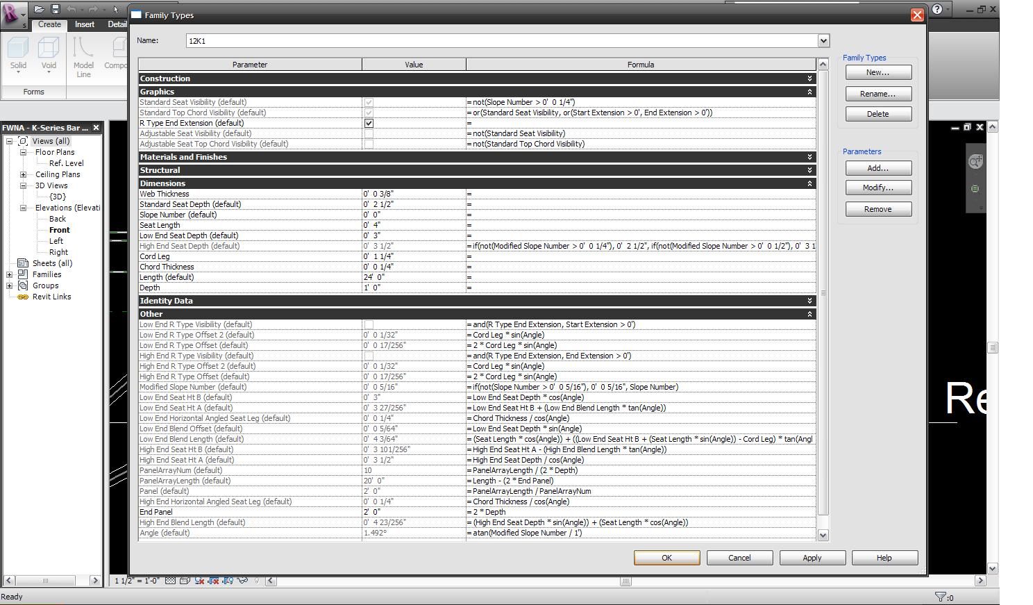

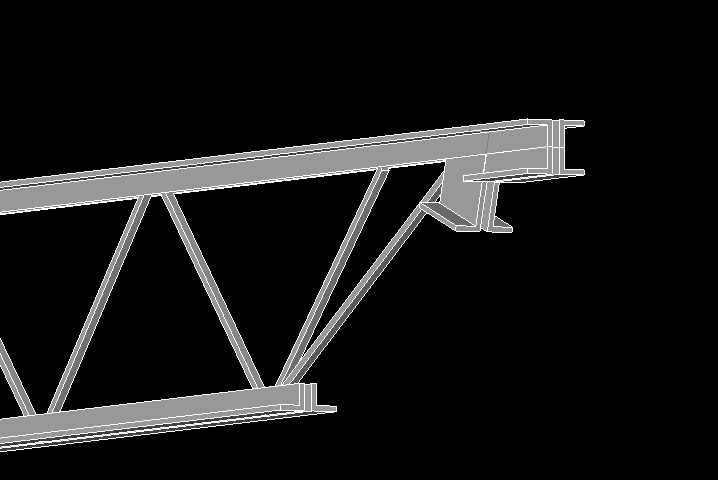

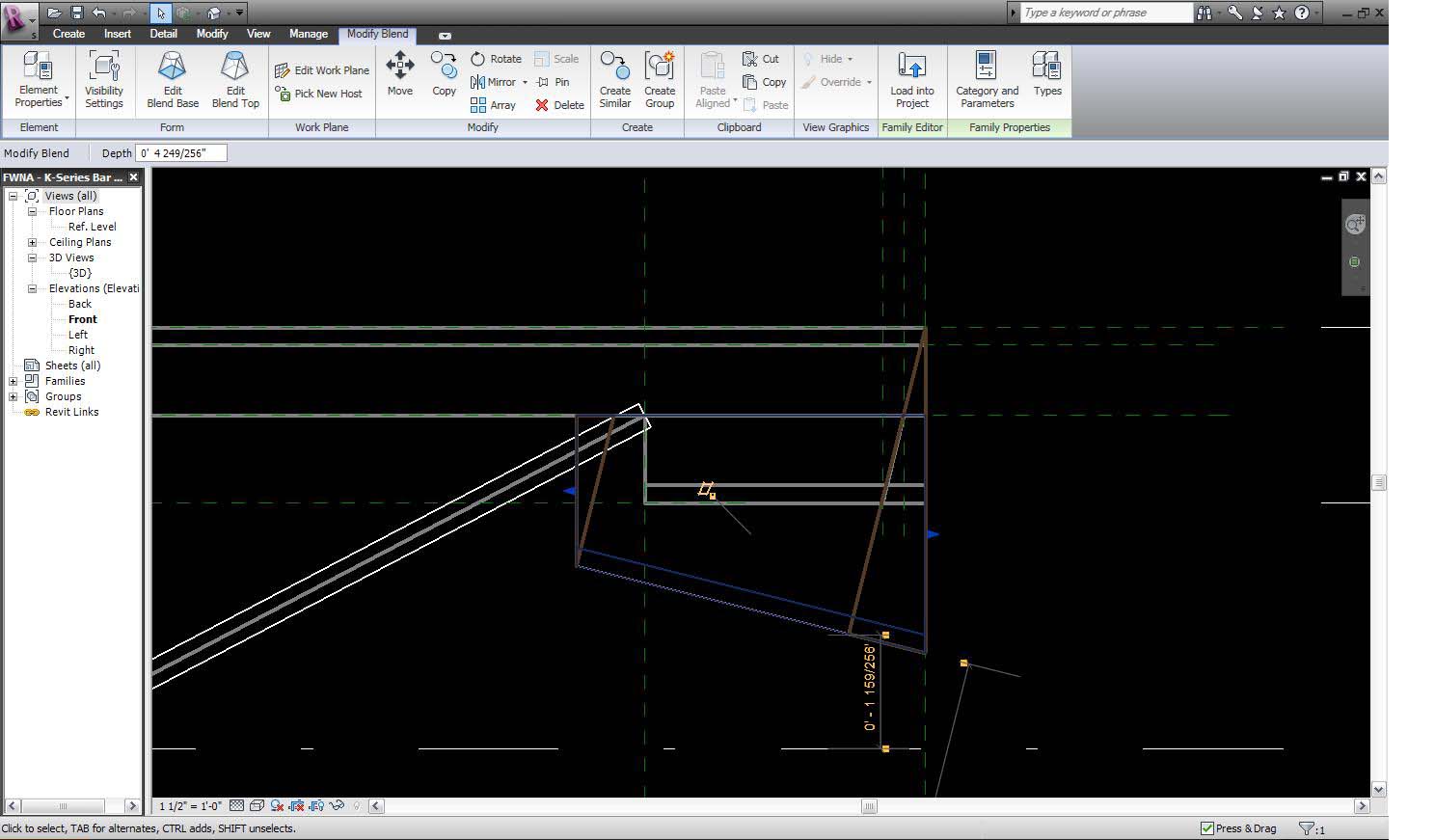

Its actually not that difficult to modify the joist family to show the sloped seat. All you have to do is add a blend showing the sloped seats, a couple void extrusions to clean it up, and some formulas to constrain the geometry and visibility.
