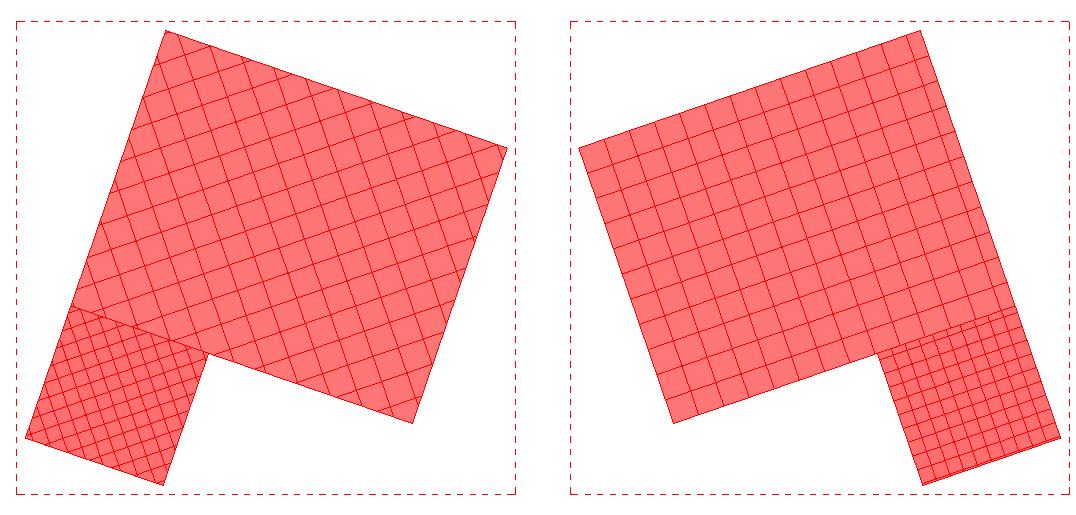

I'm using Groups for modelling apartment units that are similar in a floor plan. The problem I'm facing is with Model Pattern used on Floors. When the Groups(apartment Units) are mirrored, the model pattern in the mirrored group goes awry. I have no idea why this is happening. Please see the attached image.
Tue, Mar 31, 2009 at 11:08:05 AM | Model Pattern in Mirrored Groups
Mirrored groups has always had problems in REVIT.  I would not use an applied model hatch.  Instead, let the material supply the hatch.  If you must ... then mirror the group without the hatch, then make a new group and hatch.

thanks for your reply, wwhub.
I have actually used material with surface (model) pattern and not an applied model hatch.
