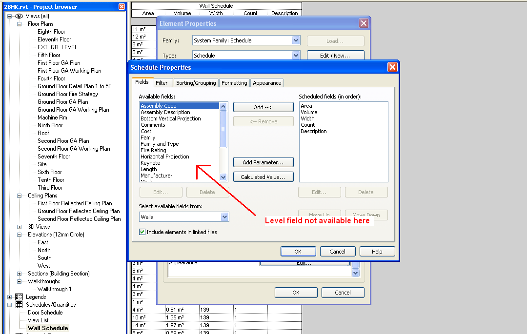

When i create the wall schedule , level field is not available.
Actually i want to sort out the walls according to level but the filed is not available.
See attached snapshot for more details
Thnx in advance

The Level field is not available for a wall schedule. You are going to have to add a parameter where you type in the level that they are attached to.
