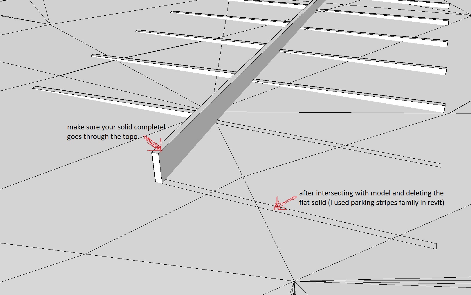

A way to possible get around this and get stripes that follow the contours perfectly is to use sketchup (requires pro or ability to import .dwg into sketchup). 1) You can start by making a simple flat solid of your parking layout in the revit model (do this however you like, it just has to export in 3d).2) Then go to a 3d view and export your topo and the flat solid to .dwg. 3) Import that .dwg into sketchup.4) extrude your flat solid parking lines as much as you need to in order for the whole layout to be embedded into all the topo.5) select the parking layout solid, right-click and choose intersect with model. This may take a little bit of time to process, but when it's done, simply move/hide/delete your solid parking solid, and what you'll be left with is a surface imprinted onto the topo of your parking layout. I would select that and move it all upwards slightly, because you'll import this sketchup file into your revit model (make sure you give yourself a way to bring it in correctly oriented). After this is done, you should have your parking stripes that follow the topo contour.
There are pro's and con's to this method, no doubt, such as a pain in the neck to modify if your layout changes, and maybe color/material limitations, but it's an option non-the-less.
