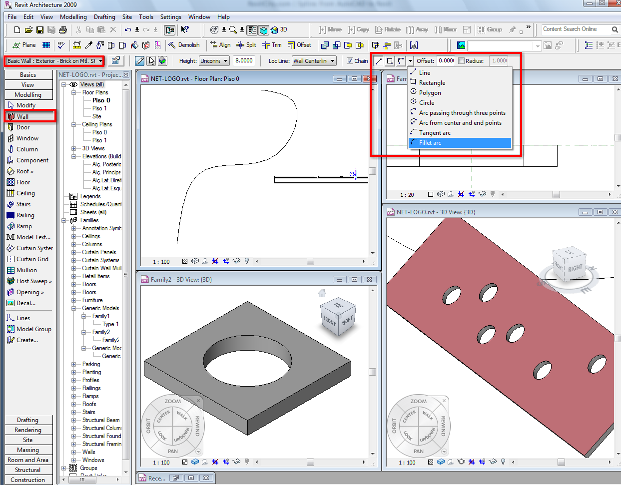

Sorry, another question.
After the full explode, how come I can't pick it anymore when I tried to create a wall?
Tue, Mar 24, 2009 at 2:32:47 PM | Spline from AutoCAD to Revit
Joined: Tue, May 22, 2007
5921 Posts
4 Stars: 205 Votes

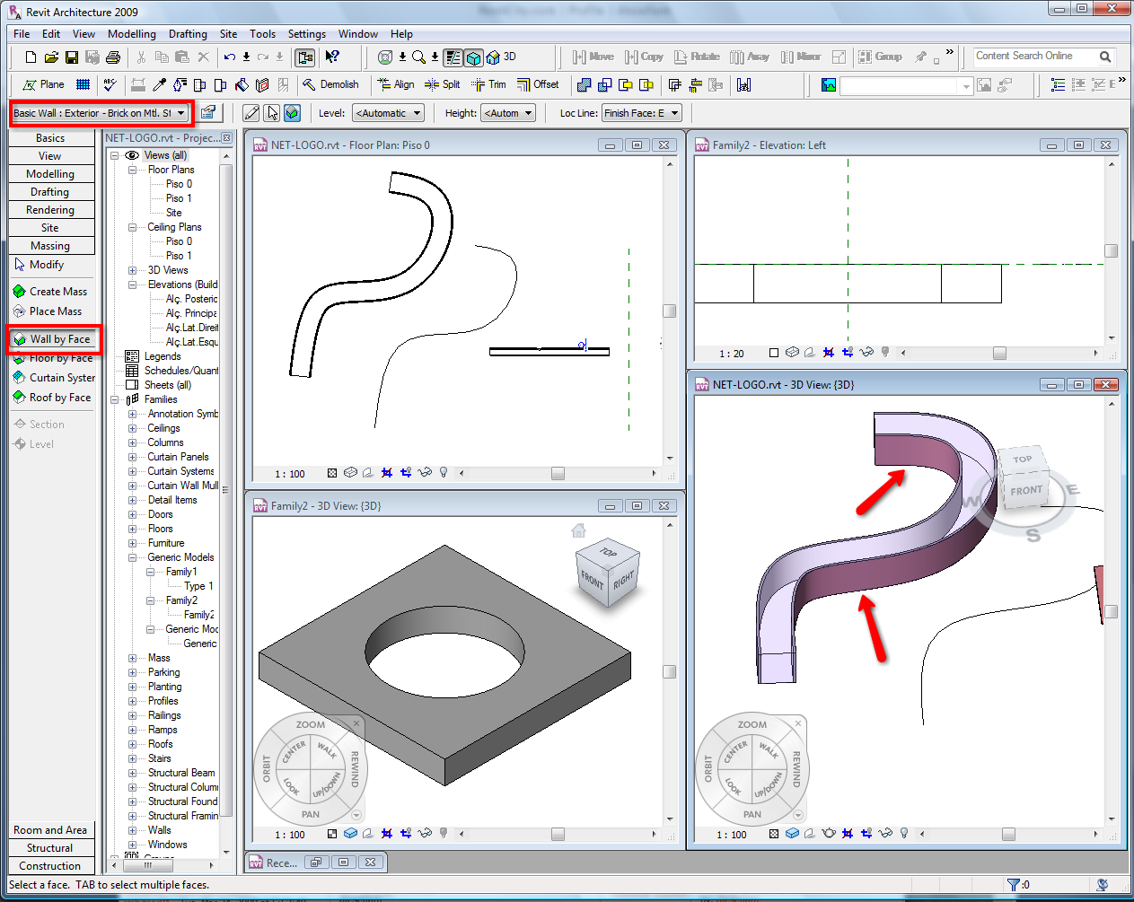

Because Revit don't allow to create wall with a spline, you don't have that option like you can see in the image attached, if you want tho create a wall to follow the spline then use the "create in Place" in the category "Walls" and create and extrusion with that shape OR create a Mass then Apply Wall by face...
Tue, Mar 24, 2009 at 2:35:53 PM | Spline from AutoCAD to Revit
5921 Posts
4 Stars: 205 Votes
There it is wall by face....

Cool man.  It works again.
So the trick is to create a mass of the spline line from AutoCAD.  Then create the wall off the face of the mass.
