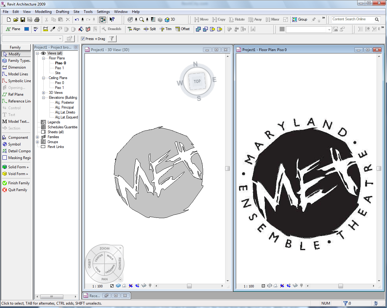

This is the logo:
http://profile.ak.facebook.com/object3/447/10/l23983837457_3518.jpg
I'm not sure I'm following.  Do I need to trace it, then extrude?

"I have a fairly complicated company logo" - Hummm I don't think so....
Use the Extrusion, i think i create that in a "Generic Model Face Based" or "Wall Based"....

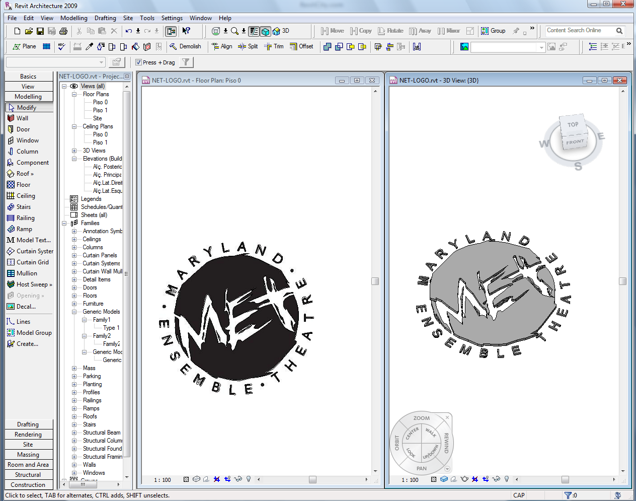

That's Finished... The text is "Model Text"...
