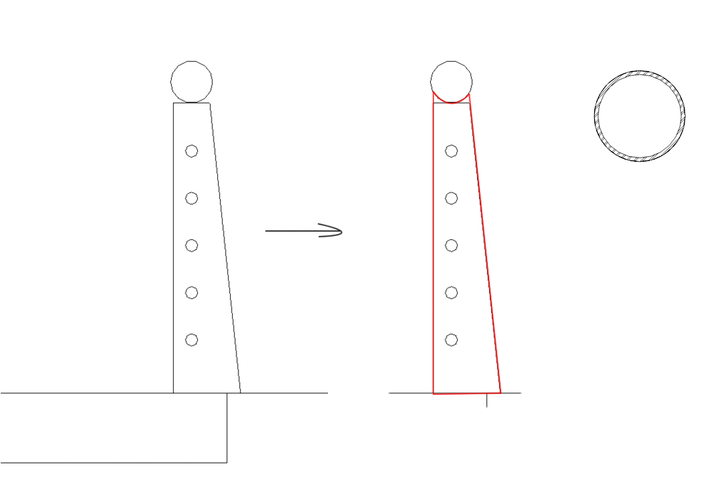

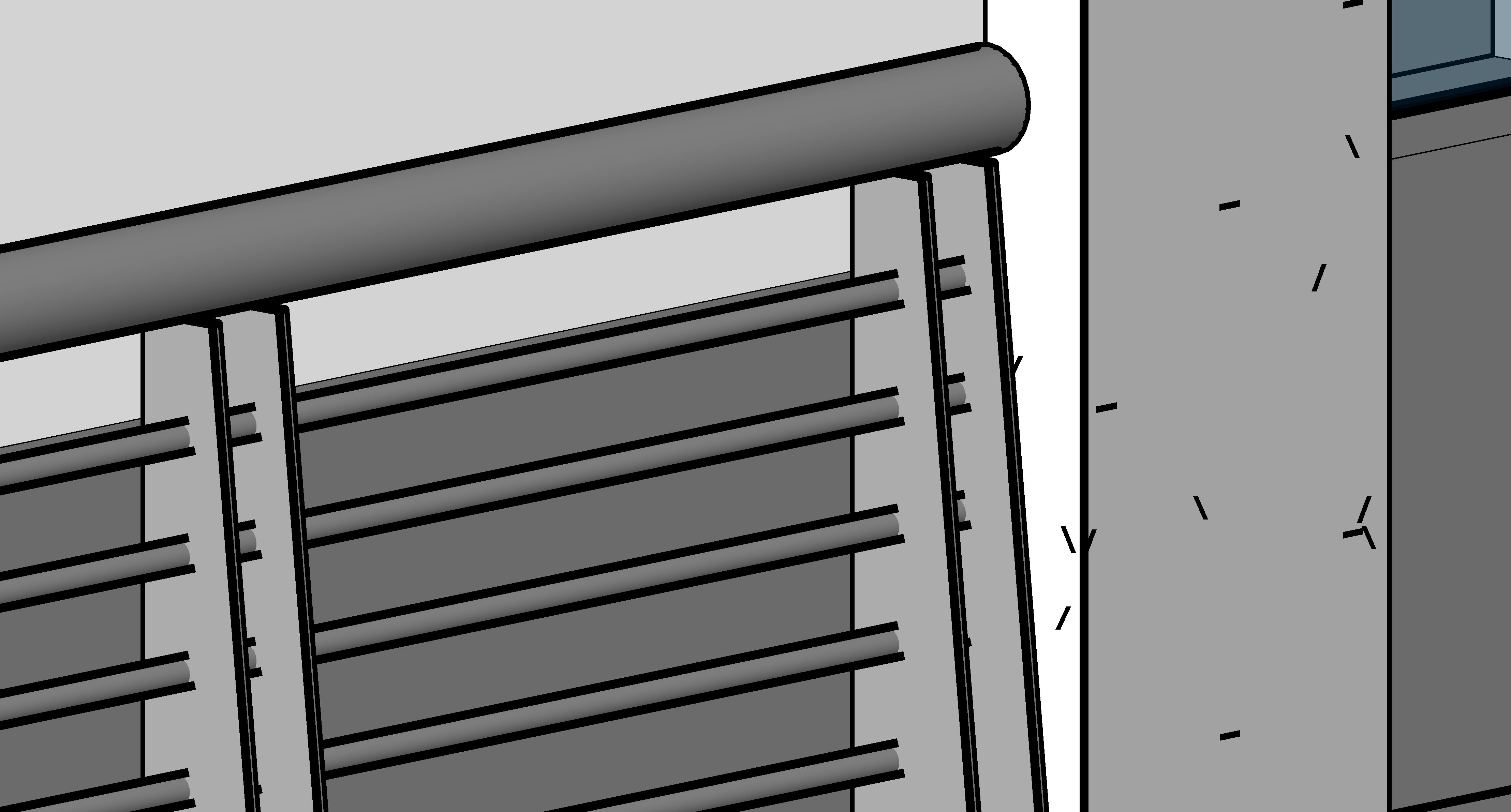

Hi, I would like to ask if it's possible for the baluster to "wrap around" the circular railing (pls see attached image).
If I increase the top offset of the baluster, protrudes out of the railing by that amount, never halfway through it.. (to give a wraparound look)

yeah i have separate family files made for the railing and the balusters. When I meant "wraparound", its where the baluster actually penetrates / intersects the railing, which doesn't seem possible. I attached another image below to show what I mean..
I tried to have a top offset for my balusters, but what happens in my revit project is that the top offset meant the balusters penetrate through the entire railing and offset from above the railing. It can't penetrate half the railing?

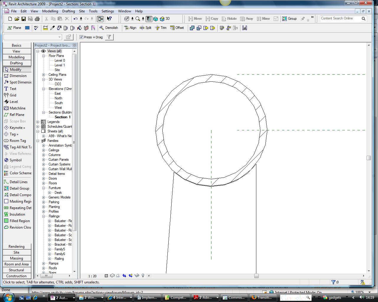

You probably need to edit the top of the baluster to wrap around the rail - see image.
The rail should show up in a section, although it will show as a solid circle and not a tube.  I have added a fill region to show the inner face of the tube drawn over the rail (which is visible).

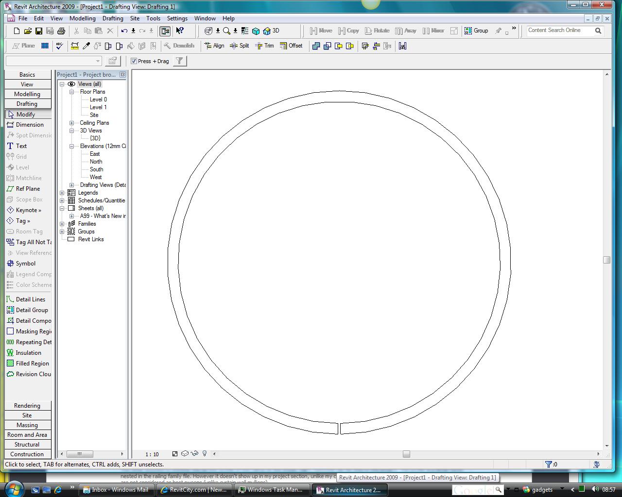

I create a few months ago something like what you want, In the profile of the baluster create that "Half Circle" like you want then with the offset (in the properties of the rail) control the position of the rail/baluster, about the other issue (rail in tube when you create a section) well, what I do is in the profile i create two circles then In bottom i create two vertical paralel lines (with the offset at minimum) and trim the lines with the circles - with this you create like a Closed Polyline....

Typhoon had the answer to this where you create a closed loop with a small opening - you can then show the inner line also - good idea Typhoon.

ahha... thanks for the image...that's a really great idea... i think i'll try to do this for all other profiles in the future too!
