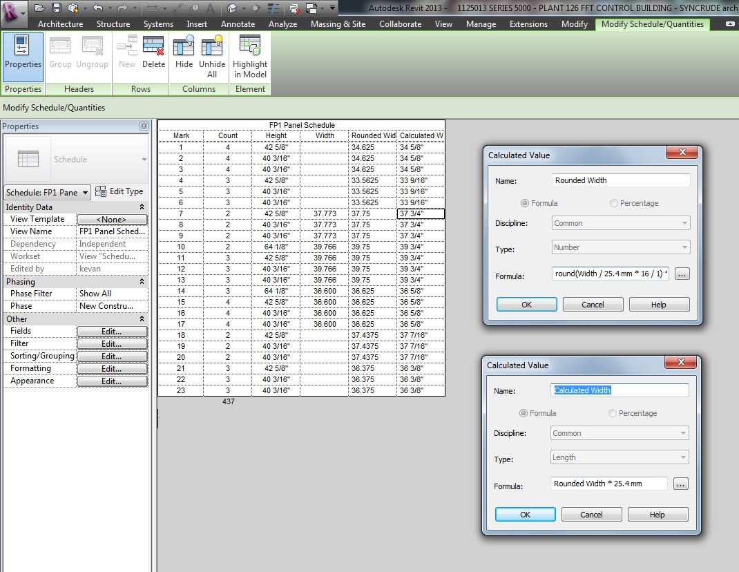

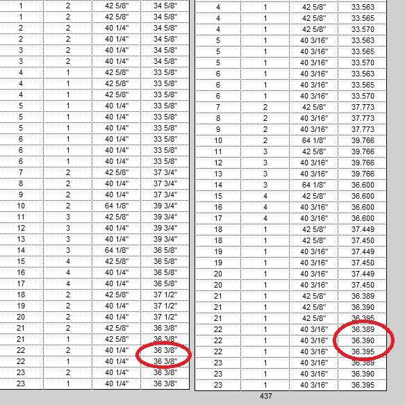

Hey Guys, I'm doing some drawings for exterior cladding panels and want to include a schedule. I'm having a problem with grouping panels that are the same size. I understand that they don't group because they are not EXACTLY the same size so I want to make a new calculated value that will round everything to the nearest 1/16th of an inch and then sort/group using that value. I also understand that Revit is designed for things to be perfect but I'm providing a schedule to a fab shop with measuring tapes so giving values to a 0.001" holds little value. And showing multiple lines items with the same values will get the fab guys "excited".
Attached is a screen shot from my schedule, image on the left is the schedule set to the units I want, the image on the right is the same schedule with the width units expanded to 3 decimal places showing how close they are without being the same.

sorry nevermind, i figured it out, but in case anyone else is wondering... here's what I did:
(to make things a little more complicated, my drawing is in millimeters but our fab shop requires imperial dimensions)
I created a calculated unitless value called "Rounded Width": round(Width / 25.4 mm * 16 / 1) * 1 / 16
Next I created a calculated Length value called "Calculated Width": Rounded Width * 25.4 mm
Sort by Calculated Width, change it to appear as "Width" and hide the other two columns.
Sorry if this is confusing, I don't really get it myself but it works!
