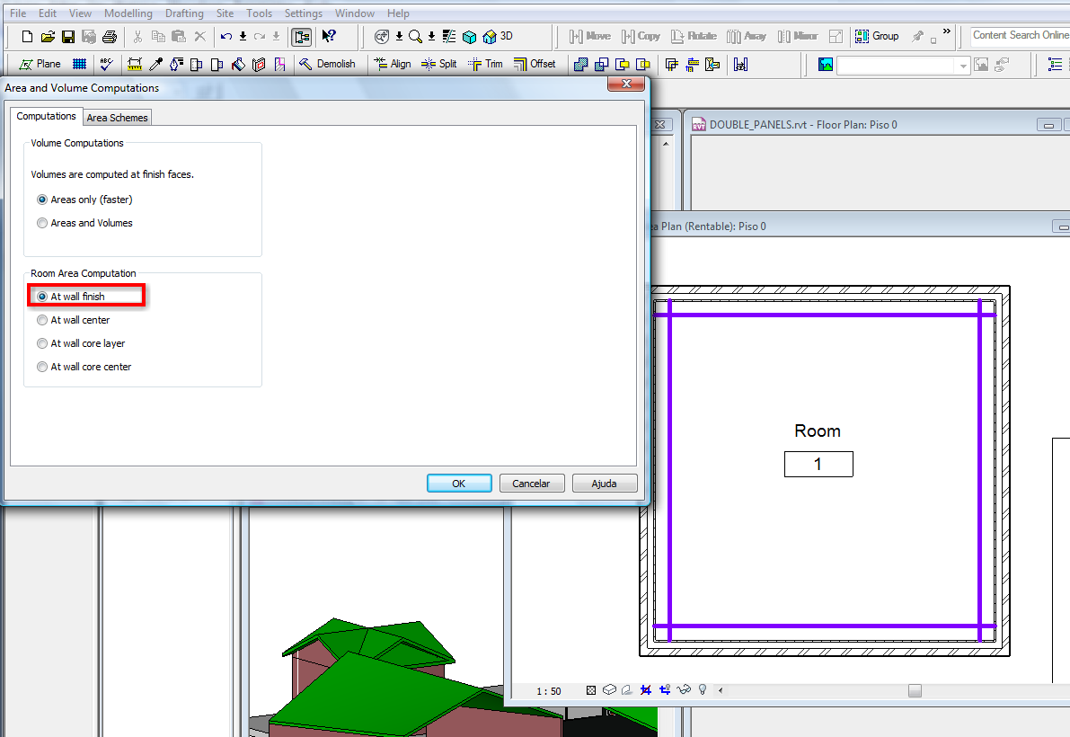

What am I doing wrong? I am trying to put room tags on a second level and they are reading exterior walls for some reason. I've checked the view range and it is cutting through the walls I am trying to put room tags in. In the option bar I have the Upperlimit set at 2nd level... for the hell of it I put it on every level and none work. I dont know why I am having this problem... it has never happened before. Thanks
Sat, Mar 21, 2009 at 7:12:40 AM | Can't get Rooms (Room Tags) on Second Level...
Joined: Tue, May 22, 2007
5921 Posts
4 Stars: 205 Votes

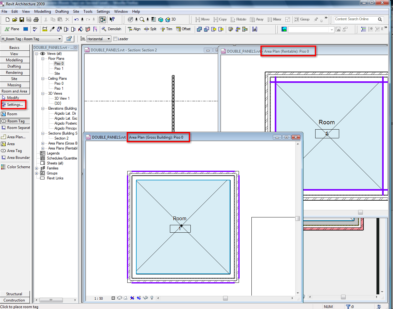

And in settings you have "At wall finish"?? they are "Rentable", "Gross"??? Did you try the "Room Separation" to check if solve the problem??

It sounds to me like the host level of the views you are trying to place the tag on is not set to Level 2?
